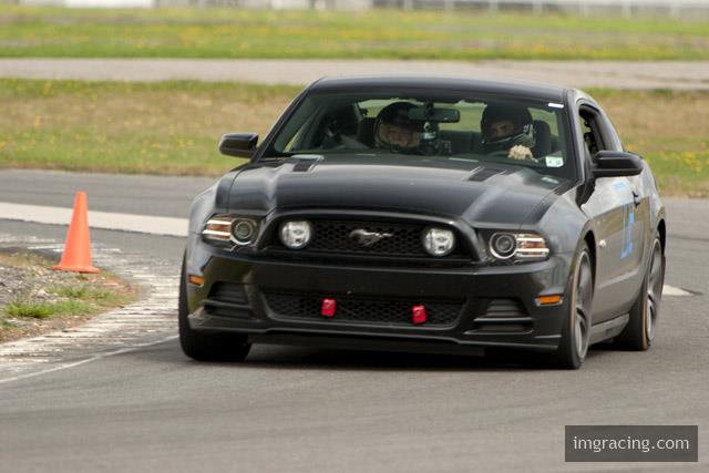

I can't believe you already cracked a rotor! Do you think the DTC70s were to blame?
Also, maybe a dumb question, but what are the red things in your lower grille in the last pics?

Red things look like timing beacons. The rotors cracked because even tho their good for the street they suck on the track. When you upgraded the calipers why didnt you go with the Brembos? Better bracking for the track and not the ceramic crap. The DTC70s are the bomb at the track!

Roadracer is correct, the red things are timing - I had my friend co-driving with me in the intermediate session and I was in the advanced group so we both wanted times.

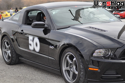

Last October I entered a nearly bone stock 2013 GT (above left) into a NASA TT event. I got the stock front brakes so hot (13.2" brakes, stock pads, stock fluid) that the following happened in two track sessions (less than 15 min each):
  • The stock fluid boiled and I lost the brake pedal, sending me off the end of a straight at about 70 mph. I went literally 200 yards offroad before it stopped.
  • Later that day, after the brakes cooled for 2 hours, I went back on track. By the end of that session the OEM front brake pads wore down to the backing plates. Metal to metal. See the picture above right of the remnants of the brake pads that disintegrated.
  • This obviously ruined the front rotors.
  • One other thing was broken but we didn't know it yet...
In December we replaced the rotors, pads with Carbotech, and fluid with Motul RBF600 and went back to the same track (also added AST double adjustable monotube coilovers with remote reservoirs). Same tires/wheels and everything else, just a brake pad/fluid upgrade and shock/spring change. Ran the track again and dropped my best time over 4 seconds, mostly due to the suspension. But the car had brake problems all day - the pedal was mush and I had to double-pump the pedal into each braking zone. And it was properly bled, by professionals.
We brought it back and re-bled it another 2 times. Still had a mushy pedal. Turns out we had cooked the master cylinder, too! So now we have to replace that, and while we're at it we will upgrade this car to the 14" diameter front rotors and Brembo 4-pot calipers, better pads, and brake cooling ducts.
Moral of the story is: don't take track event brake prep lightly. If you show up on stock pads and fluid, be prepared to potentially take a ride...
