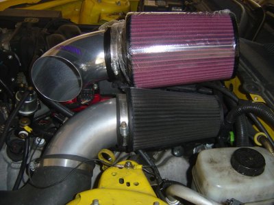

Increasing air intake. Today/ tomorrow I will be installing a GT500TB upgrade from RPM(many of you love that place http://rpmoutlet.com/05gtbbk.htm ) and Anderson motorsports powerpipe for the procharger (http://www.andersonfordmotorsport.com/dynojet/05GTATIPPhoodclosed.jpg)
1. Both these items say they can be installed withOUT a tune. IF I install both of these and do a little ram air.. can I get away and drive it safely without a tune? I plan to get another tune soon.. but can I get away with it and will I get some hp?
You can see the difference between the stock procharger filter and the Anderson power pipe :evil:
The GT500 TB will be a very close fit because there is almost no room to move the procharger intake pipe back to fit the spacer and TB. RPM said it fit on their F1 and "Should fit". I think it will with some knuckle banging :idea:
