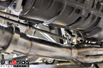

In these pictures above and below you can see the completed swaybar assembly. The arms are bent - both for tire clearance (inboard) and to line up with the C6 Corvette control arm's endlink mounting hole. The arms were drilled for multiple adjustment holes as well. Some of the items shown are only tack welded at this point as some final checks still needed to be done once the car was off the frame table, sitting on the wheels and tires at ride height, and rolled onto a 4 wheel alignment rack.
Ryan built a pair of adjustable length swaybar end links out of threaded rod ends, threaded weld bungs, straight tubing and some misalignment spacers for the bolted ends.

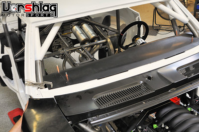

BODY PANEL FITTING
The car owner had sourced some pretty slick aluminum bodywork for the forward section of this chassis. This Norwood kit was made by Auto Metal Direct for the 69 Camaro and included all aluminum sheetmetal forward of the doors and cowl. These pieces had been bolted in place (with several custom mounts) earlier but now it was time to fit the hood and try to get the panels to align better.
The only problem with these aluminum bits is they bend easily and it looked like a number of the parts were bent somewhere along the way, possibly in transit, especially the 2" raised cowl hood.
One corner of the hood was bent down and the culprit was a popped set of spot welds in the corner of some under structure. Easily bent back and fixed.
After fitting, massaging, and reinstalling the ADM panels they were looking much better and ready for the painter - who would get the panel gaps and fit-up perfected just prior to paint.
Maybe in retrospect an entire composite front end would have been a better choice. Heck, a fiberglass unibody might have been better. Hind sight is 20/20, and we suggested a new body at the very start. It wasn't until we put in the hours of tweaking and rust fixes that the car owner saw that, too.

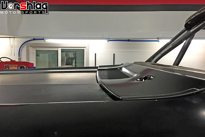

INITIAL HOOD DUCTING TESTS
With the aluminum front bodywork panels fitting better it was time to choose the hood venting. The whole front end - splitter, various coolers, radiator angle - were all going to be built around a vented/ducted hood, from the very first conversations we had with the car owner. The actual design decision was a long process.
The car owner had noticed some of the other vented and ducted hoods we had built in the past and understood aero enough to know how advantageous this setup would be for making front downforce, proper cooling, and a better layout. He also sent us 20+ pictures of other modern race car hoods and splitters, for styling and functional examples.
We struggled to lay out some appropriately sized and placed hood ducts on the existing aluminum 2" raised cowl hood, but just could not make something that fit within the geometric confines of the raised cowl. As good as this hood looked on this chassis, it just wasn't conducive to proper placement of the rather large vent holes we felt were needed to exhaust the airflow from the radiator, oil cooler and power steering cooler.
The car owner was reluctant to lose this raised cowl hood, which was understandable, but we didn't want to start cutting on it without trying something else first. So we found a stock 69 Camaro flat steel hood and I piked it up for $150 locally. We fitted this hood to the car on our dime and then started mocking up hood duct vents to show the customer how they could look on flat hood.
After a few tape mock-ups Ryan started cutting the expendable steel hood so he could show real, 3D duct layouts. The locations of the coolers, the placement of the engine, and the low pressure zones on this hood (in our imaginary wind tunnel) dictated where the vent holes and duct routing should end up. Our engineer Jason wanted these large vent sizes and Ryan made this first cut and then the cardboard ducting mockup, above. I then photoshopped this mirror image to show what the final hood would look like with these vents. Not quite what the customer wanted, but we were getting closer.
The gap in the middle of the hood between the two vents was there to clear the engine's intake tube, of course. The angles of the ducting underneath were constrained by several things - the placement of the coolers, the upper chassis braces (including two forward pieces not installed yet), the best low pressure location on the hood, and the tires themselves.
There were also some placement constraints from some styling lines in even the flat hood. The ducts really needed to be outside of the lines (see above) that the flat hood had, so we went on a search for a truly flat 69 Camaro hood.
We took a lot of pictures trying to show the owner the constraints that dictated the placement of the vents. This is just a sample of the mockup designs we did. The 315mm tires at full bump travel were a constraint. So were the frame rails and upper tubing placement. And the location of the radiators. Plus we had to make it look "right".
Not only are the vent placements critical for function but these will be the single most critical cosmetic item on the car. The hood vents and ducting could make or break the look of this car, and getting rid of some useless styling lines in the stock flat hood opens up even more possibilities for the vent hole shapes and placements (see below).
Long story short: so we ordered a custom composite flat hood without the two styling lines normally found on an OEM 69 Camaro flat hood. We will address this design feature further in a future post, after this hood arrives...

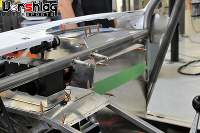

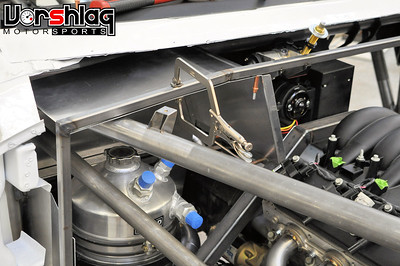

Our second question here related to the windshield wiper system. Because the factory firewall has been moved significantly, it would be an extreme amount of work to use any of the OEM wiper system components. After researching various options, we felt that a synchronized, direct mount wiper motor system is the best option. This eliminates any linkages that would need to be designed, and instead mounts the wiper arm directly onto a degreed sweep style wiper motor. The industries these style of motors are used in are either motorsports or marine applications. We contacted Bosch to receive more information on their programmable Motorsport WDA and found there are currently only 3 available in the U.S. with an asking price of $890 each, and the car would need two.
The second option we found was a very reasonable wiper motor sold by Marinco. These models have sweeps ranging from 45° to 110° and come in a very compact size. Our plan was to use a three-position switch, giving the driver control of "park", low, and high wiper speed options. With an average price per unit of $150, we could get two of these for less than a third of the price of a single Bosch WDA. Mounting would be straightforward with only one bracket being fabricated for each motor and no linkages needed. Will show more of this after we get a chance to install these parts - we need a windshield and a cowl panel back in the car to design around.

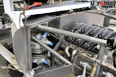

REAR SEAT AREA CROSSMEMBER WORK
The original rectangular rear crossmember behind the driver needed clearance for the driveshaft and exhaust. Now that the driveshaft had arrived it was time to make the U-shaped clearance section and add some tubing to the top to tie into the 3rd link mount cross bar.
Ryan laid out the shape he wanted, marked center points for some holes, then hole-sawed two massive holes shown above for the corner radii...
He then cut out the parts in between....
Used some flat stock to make the curved section...
Ground everything smooth and flat....
Then clamped his pre-bent curved section in place and spot welded it along the edges.
Then the custom aluminum driveshaft was installed. After that the curved tubes closed the box around the U-shaped section and tied into the rear upper 3rd link mount cross bar. Then the 3-rd link mount on the chassis end was modified.
The upper bracketry was changed to add multiple pick-up points for the upper control arm, just like you can see on the lower arms at the chassis side, for additional rear suspension geometry adjustability. The 3 rear control arms are all adjustable for length as well.

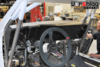

BODY ONTO CHASSIS, DRIVETRAIN INSTALLED
This was exciting - reunification of body and chassis! At this point the unibody was so trimmed away and light that it was really easy for 2 people to lift it. Using 4 people it could be spread apart and fit around the roll cage structure and frame rails in half a minute. Once this was tack welded to the frame rails it wasn't ever coming off the frame again - this isn't that kind of body. A composite body is usually made to be removable, but this steel unibody will need to be welded to the frame - hence the reason for painting the areas we did.

This shows the complex routing going on within a handful of inches. First, a crossover to get both 3" exhaust tubes on the same side. This is turned into an X-merge of both pipes, but not the traditional type. Admittedly space constraints made this all look pretty compact but it will be worth it when the flat bottom panels are built.
The shot from underneath shows how critical each of these bends had to be calculated, measured, marked, cut and tack welded.
Here you can see the clearance to to the shift rods as well as to the driveshaft yoke. What may not be evident is that the drivetrain is shifted off center in this chassis, away from the driver. This designed in drivetrain offset is normally done to give additional clearance from the steering shaft to the exhaust and to counter the driver's weight. In this case it made additional room to route the exhaust on the driver's side, buried up in the transmission tunnel.

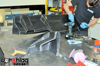

Using a metal dash in a car built like this doesn't make a lot of sense, so we ordered a VFN fiberglass 69 Camaro dash with the customer's blessing. Installing this inside of the elaborate roll cage structure would prove to be a challenge. Nothing is ever easy on a race car
First, the bottom section of the OEM shaped dash had to be clearanced to clear the cage mounted steering column brackets that were used. These billet brackets hang down from the "dash bar" of the cage, shown below.
After the bottom section was clearanced it cleared the column, but there was no way to get it in between the A-pillar down bars and FIA compliance vertical bars in the roll cage structure.
The dash had already been clearanced on the outer edges for the A-pillar bars but to fit into this tight space it would need to be put into 3 sections. The best cut locations were chosen and marked, then Ryan carefully cut the dash panel with a body saw, down along the complex shape of the dash.
To re-join these 3 sections inside the car, the outer two "ends" of the fiberglass dash had "doubler plates" added, which were hand made from aluminum sheet. These were Cleco'd to the panels and tested/fitted, before being epoxy bonded and riveted to the main composite panel. The center section of the dash will unbolt from threaded rivnuts added to the doubler plates.
Here the 3-piece dash was fitted and assembled between the jungle gym of cage tubes, joined along the two joints / doubler plates with Clecos. Once this was fitted and mocked up in the car, the outer dash sections' mounting brackets could be built to attach to the cage.
Above left you can see one of the steel mounting brackets being fitted. This was then TIG welded to the roll cage bar and Clecos joined it to the dash panel (which will be replaced by bolts and nuts at final assembly). Above right is the other bracket, welded to the cage and Cleco'd to the left end of the dash. The 3-piece dash is now re-assembled and mounted into the car. The seams where the dash join together are tight, and once bolted together with more than a few Clecos, it will have an even cleaner finished look.
The dash was mostly mounted at this point, with a bit of a bow in the fiberglass on the unsupported bottom edge. We added additional mounts to the dash when the forward transmission tunnel was completed (shown out of order above). A bit more trimming was necessary at the bottom of the dash, due to the extreme driver setback and long steering column length. The dash panel is there for cosmetic reasons, as there will be a digital dash mounted to the column closer to the driver.

To mount the defroster / heater core / blower motor enclosure required a section of the tunnel covers be built, then a lower "box" frame - both from aluminum. The lower box section was cut and bent to shape, then it was bolted to the tunnel section shown below.
This all made for somewhat tight confines under the dash, with the various components hidden under there - wiper motors, defroster, dry sump oil tank, etc. I will show the wiper motor mounting in a section below. But here the defroster box is mounted and ready for heater hose plumbing and some air 3" hose to the windshield base vents, to be shown in a future update.

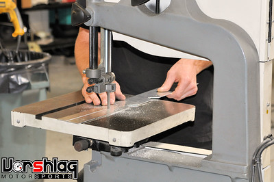

Templates in cardboard were made for various panels. These templates were then transferred into 3003-H14, .063" thick aluminum sheet. These metal panels were marked, sheared, bent, trimmed, deburred, fitted, and then drilled for mounting holes. Depending on the location the panels will be either riveted or bolted in place.
Step by step each template was turned into an aluminum panel. The picture above shows how some of these panels join to the composite dash. The passenger foot well area is also very different than the driver's side, to clear the massive dry sump oil settling tank, which has a complicated firewall structure around it. There is still tons of leg/foot room due to the front seat setback.

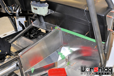

The complex shape around the exhaust header on the passenger side was taped together at first. These sections were then tack welded in the car, removed, and fully TIG welded on the bench to make a single panel. The shape of these panels will give the most interior room and allow for the unique, above floor exhaust routing.

The cowl section this car came with was a modified version of the OEM parts, but clearance for the set back engine was too tight. It was also hacked up, rusty, and needed complete replacement.
The remaining OEM section of the cowl is there to give the windshield a place to seal, and it has been blasted, primed and painted.
We needed to join this to the new, tubular firewall structure with a steel panel that has several compound curves and bends. Like the side panels above, it will be welded in and gives additional structure to the windshield base.

FIREWALL - DRY SUMP TANK AREA
The dry sump tank area is fairly sizable and a mount was built for the dry sump tank earlier. Now it was time to make a metal firewall enclosure around this tank to seal it away from the passenger cabin. All of the remaining OEM steel unibody structure around the tank has been blasted, primed and painted, so ignore the rusty picture (below left) from earlier in the project.
This dry sump enclosure had a complex shape that required more than a dozen individual panels to complete. The tank had to come out a few times to make room for patterns and panels to be built, step by step.
Some of this enclosure was built into the interior panel section above as part of that task. Again, many of the tasks shown in this update were built concurrently - parts were fighting with each other for space.
Several cage and chassis tubes pass through the top of this "box" around the dry sump tank, so those panels had to be bisected around each tube. The dry sump tank has a lower drain fitting, so a hole in the bottom panel was added to facilitate draining during oil changes.
The end result looks great and works well, but most of this will be hidden under the composite dash or the cowl. It still needs to be there to seal the cabin from fire / fumes / fluids, of course.
