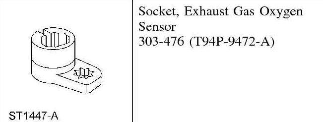

I tried every way imaginable to put a socket on that sensor, but I could never get it close to fitting. I probably wasted an hour playing around with that. The tool that could possibly work was
- or actually the 7/8 crow's foot I bought from a local parts store.
Even with the crow's foot, I could only turn it about 5°. My brother-in-law broke the code and showed me that if I set the ratchet to loosen, the crow's foot flopped the wrong way. If you set the ratchet to tighten, the crow's foot flops the right way, then you switch the ratchet to loosen, turn a little, move the crow's foot, loosen... For installation, get it finger tight, then reverse the process.

Different car same problem, I was able to use a 12 point box end wrench to get it off. I opened the connector and put the wire through the wrench. The chinease O2 sensor crow feet type sockets are anyway very weak and spread under load.

I have one of these. Don't remember where I got it and I'm not sure how it works with the stock sensor locations but I can fit it in most places I've had to.
