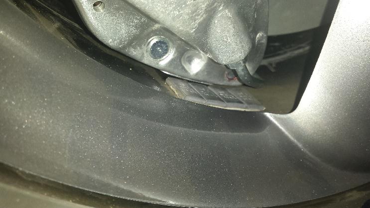

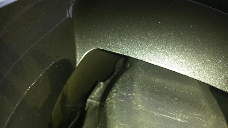

So I had the S550's already, which I got a couple years back when
Rousch was selling brand new takeoffs. It looks like with my 18 X 9
Bullit knockoff, I would need new studs and 3/4 inch spacer for S550's.
S197's, It looks like I can get away with stock studs and 1/2 inch
spacer. Studs and quality spacer I'd need with S550's seem to be
pushing the price of these knockoff calipers from rockauto.
Anyway, some pics and measurement of rotor hat face to outer
edge of each caliper. Appears to be about 3/16 inch difference.
Less that I hoped for after trying to fit S550's.
Clearance with S197's
Using nuts and washer that add up to .535, 255 tire sticks out a bit.
Spacer I was thinking of, mainly as it appears to be
hubcentric
Stock base 14 GT line vs S550. Looks to be the same
on chassis end anyway.
Also, does anyone know the stock MC bore sizes of a 14 vs 15 Gt's?
Caliper pistons seem much larger on S550's, would think MC enlarged
to match.
