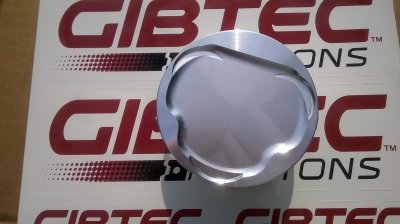

I used Gibtec Pistons and went with the Total Seal ring package they recommended. Being a custom piston manufacturer they know what they are talking about.
You should also check out a thread over on the Modular Fords Forums titled "Gibtec Aluminator Build" it has everything you could want to know and more.

You need to talk to Nick at Gibtec when you call.
What makes Gibtec the best is that it is a 100% custom billet piston. You can get it made in any size, any shape, any ring package, any skirt shape, etc... Again... 100% custom.
And at a very reasonable price. I paid about $1300 including .200 wall wrist pins, Total Seal rings with support rails, and moly coating on the piston skirts. My pistons also included offset pins, a custom diameter to get the perfect piston to wall clearance for my honed block, and a custom ring pack gap with an anti-flutter groove.
Basically... Don't settle for some other company who only sells off the shelf .10, .20, or .30 over pistons. Gibtec will make any diameter piston for you in .001 increments. They can also move your ring package up or down, change ring land widths, etc. And they can shape the piston dome / dish to get any compression level you desire.
Again... Custom... Talk to Nick.
