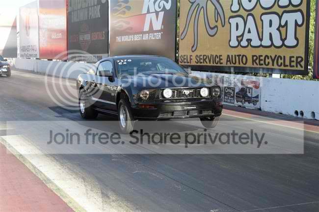

Mastering the art of the S197 3 link suspension (sixty foot)
silverpoison
Apr 14, 2007
3,360
SoCal
1.41 60'
Tokico dspecs
CJ springs
Metco Uca with HD mount
Metco LCA's with relocation brackets
BMR pabhard bar brace
CE adjustable panhardbar with rod ends
Racecraft Antirollbar
3.55 gears
Spool
for now using MT ET Drags 28x10.5-15
