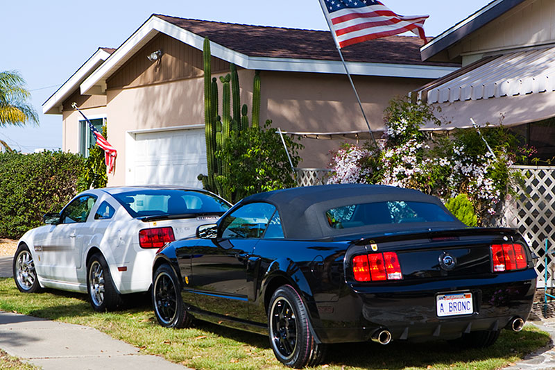

This will not likely be your solution, but it will give you some data points to reference in your search. Both cars have SVT GT500 (read: 'Heavy') 18x9.5 wheels. They have -45mm offset and 7.125 backspacing.
Tires on the white car are 285-40; black car, 255-45; both are 'standard' diameter.
Front car is on FRPP 'P' springs, -.75 front drop, -.5 rear; rear car is on standard springs.

I like the way the white one looks. Thanks for the reference info!
