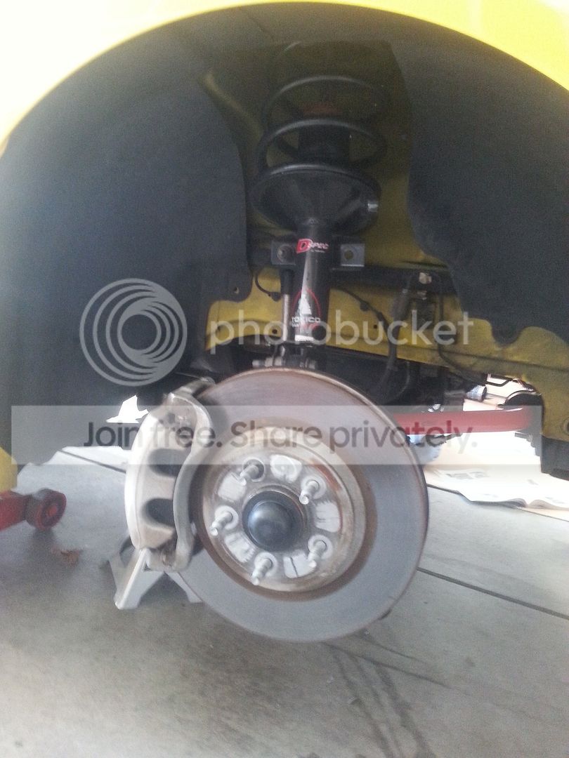

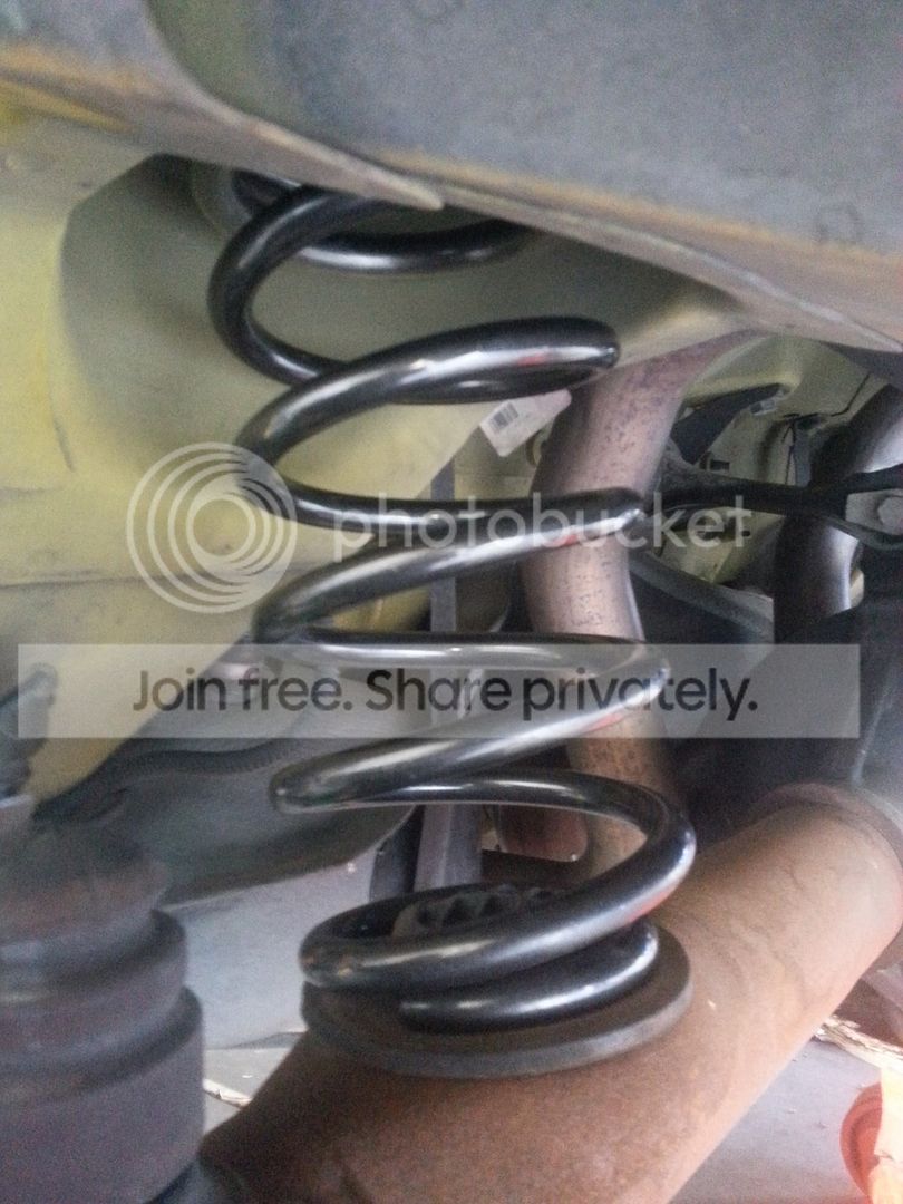

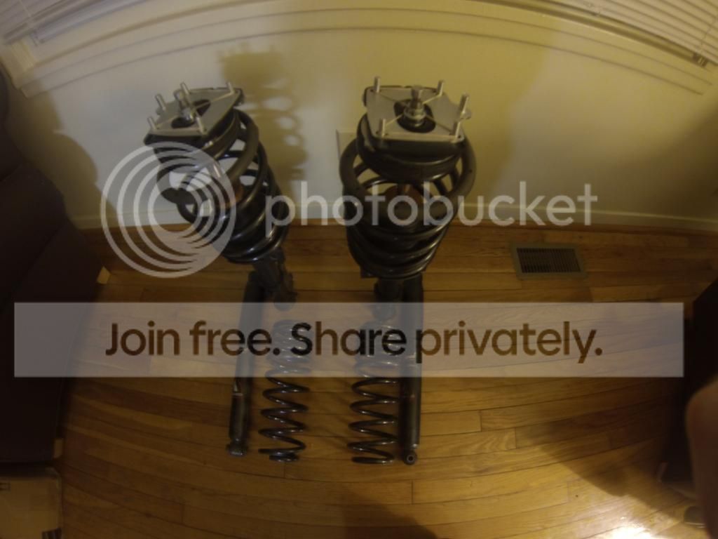

The stock suspension was really leaving much to be desired in the tight twisty roads I LOVE and ENJOY here in New Mexico(wouldn't think it but there are some GORGEOUS roads). I love tearing up the mountain and canyon roads just as much as the track... so I was left with some serious things to debate. First was a solid suspension setup.
After browsing youtube, this FANTASTIC forum, and multiple websites, I decided I would stick with strut/shocks and springs for now. If I didn't like the combo I was planning on going with I would just bite the bullet and get a good set of coilovers and be done with it.

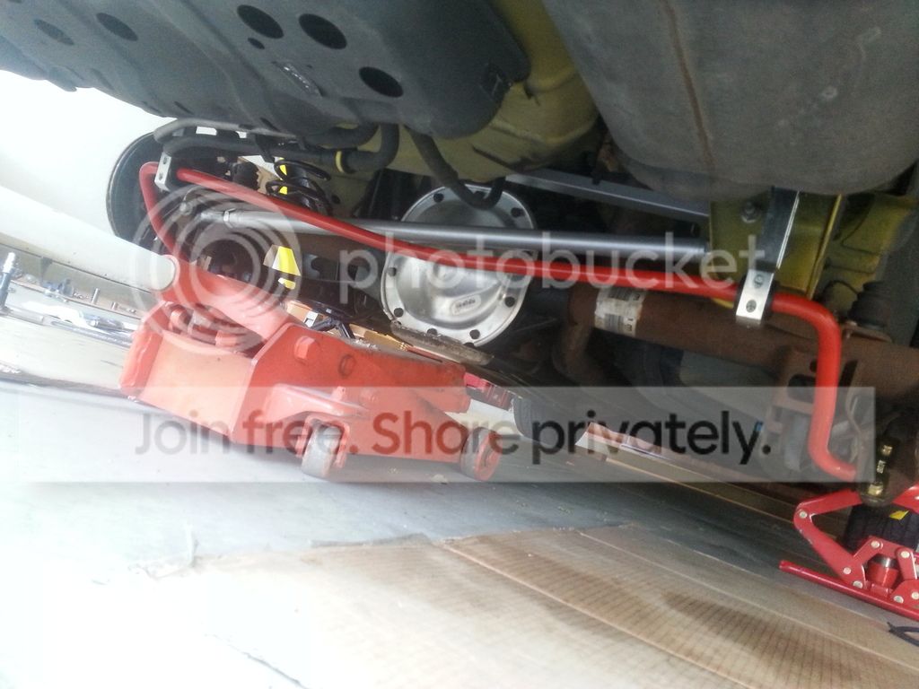

My biggest issue was dual purpose... I wanted a toy at the track but it needed to be liveable on the streets. It isn't my only car so I don't have to daily it, but I still enjoy driving it on the roads. So adjustable struts and shocks were a must. After browsing multiple websites I found what I wanted in the for sale threads here and picked up a set of Tokico 7 way adjustable shocks/struts. I was a bit worried that I wouldn't like them but I had some money put away for a full coilover set so my mind was at ease at least. I then picked up a set of Eibach performance lowering springs. They offered a small drop, and seeing as I can't SLAM and WON'T slam it, it seemed like a logical choice.

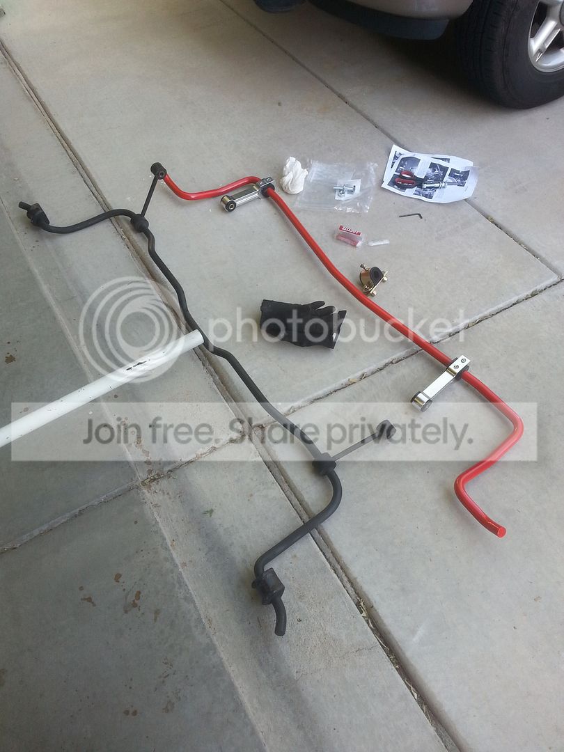

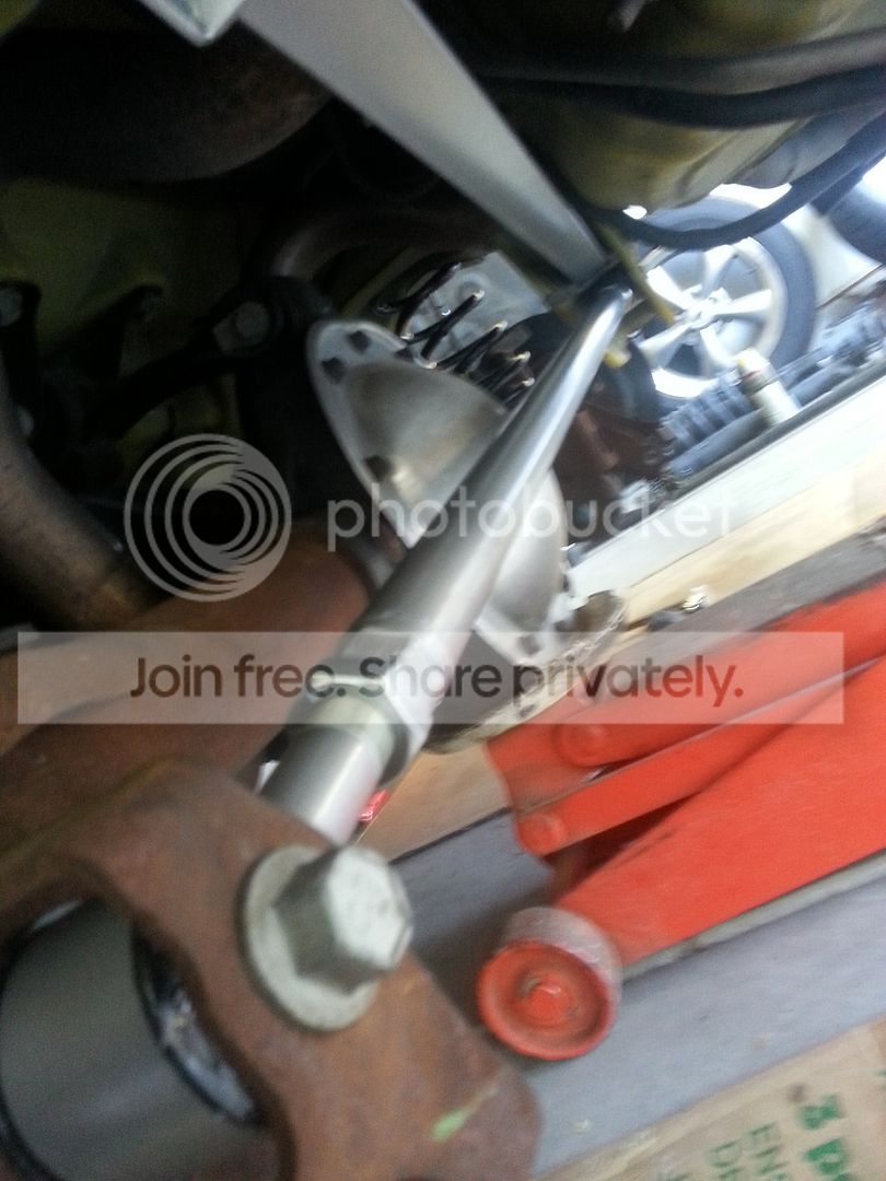

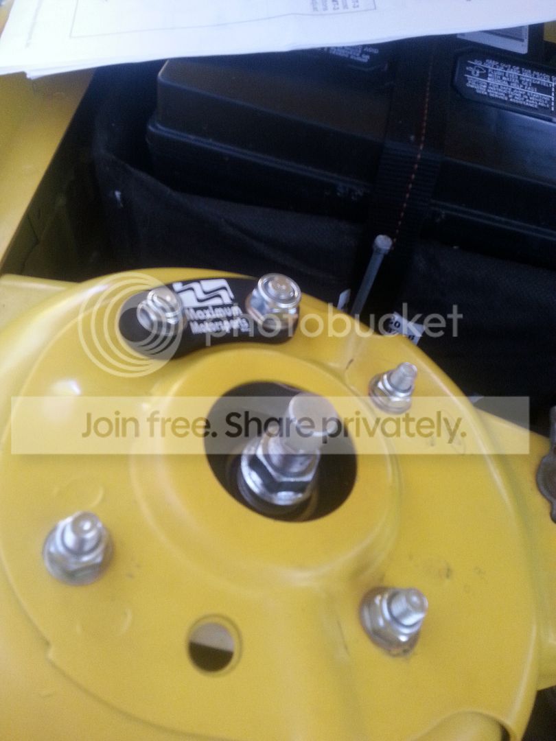

some MM Caster Camber plates topped it off. I also decided stiffening up the rear and a solid set of sway bars would definitely help it in the corners.
A few other goodies from whiteline and it the rear end was getting the attention it deserved!

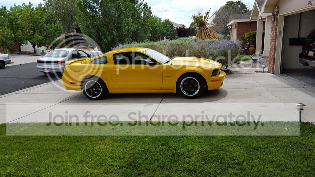

And I put the wheels back on her and took her to a shop for a performance alignment.
After that I took her for a NICE LONG drive through some canyon roads. I am SUPREMELY impressed at the difference. There is no noise coming from the suspension, it's quiet... and most importantly it is BEYOND flat in the corners. You load the suspension and there is no evident body roll.
I had a few friends take her for a spin and they were left in awe at just how confidence boosting it was in tight corners at speed.

Not criticizing, but any idea behind why you went with an aftermarket rear sway? It's a commonly held feeling these cars need a lot of help in that arena up front compared to back. Was it for auto-x turn-in rotation?

The main reason for the aftermarket rear sway was to replace the stock component and really fiddle with fine tuning it(keeping it or going for something else). I might be changing it as time goes on depending on how the turn in's go at a few local SCCA events.

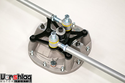

There are all SORTS of bolt-on doo-dads that you can choose from, but the beneficial ones are: Rear Lower Control Arm relocation brackets (LCA brackets), Watts Links, better anti-swaybars, and adjustable rear LCAs. There are significant differences in brands and there are lots and LOTS of bolt-on trinkets you can buy that do nothing.
