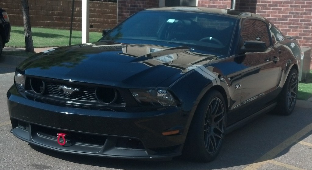

I ran 315's on 11's on the front. Lowered a lot. Stock fenders.
http://www.vorshlag.com/product_info.php?cPath=141_142_268&products_id=624
I'm running 315/30R19 tires, 19x11 wheels, 50mm offset, and a 1" spacer on the front. My passenger front tire is just barely rubbing the fender at autocross events. The back and driver fit perfectly, so I wonder what's up with that corner. I think that I'm going to talk to a body shop in town to see if they can flare my fronts out a little.
