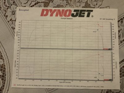

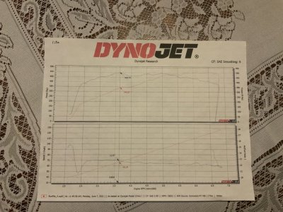

Looking at the choice between two tuners I have two dyno charts that were run within an hour of each other. No changes were made to the vehicle of any kind. Only the tunes were changed. The first chart is the final Brenspeed tune. It ran very well with no bad habits but burned my eyes at idle. Brenspeed was done with me at this point. The second chart is a Lito tune. It runs stronger and does not smell as bad. Lito was also willing to make adjustments after this chart was made and has responded to every inquiry I have sent him.
Look at the torque from 3000 to 5000 and the difference in peak HP.

The Brenspeed tune looks like it is for stock rods and pistons.
At 3500rpm, what is that Brenspeed tune running for timing? Maybe 11-12 degrees?
I wondered about that but there was no reason for them to keep the engine under 450rwtq when it's fully built with a forged bottom end and can take a lot more.
The 12:1 AFR across the board was right where it needed to be. I guess Brenspeed was just being conservative with the timing to keep the engine safe in case the IATs become too high in the summer months. One way or another, Lito's performed something of a miracle and fattened up the torque curve.
