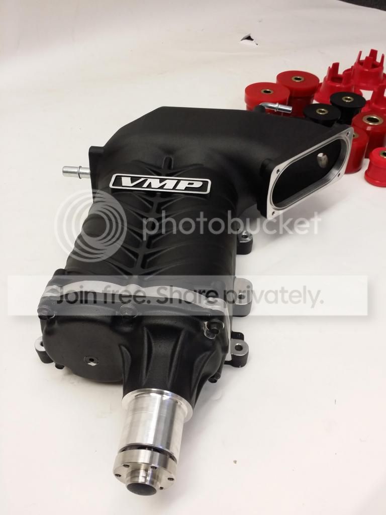

So I was able to get the car to the track a few days ago.
I cannot stress how happy I am for the first outing - especially knowing how much more is in the car.
Justin@VMP and Ken@Lund have been such great help - I am very fortunate to have these guys involved. Ken has the tune down really nicely at this point, but he still says he has more to do.

For those who have gotten a little lost in the thread, here is a recap for these passes.
2015 Mustang GT Automatic / 3.15 rear gear / Stock Transmission and Converter
-Kesatie Motorsports Built Shortblock
-VMP Gen 2 Supercharger with 69mm Upper Pulley
-VMP Twin 67mm TB
-JLT “Big Air” CAI
-JPC Racing VC Fitting / Crankcase Breather Kit
-ATI Super Damper
-Custom Return Fuel System using a Lethal Performance Twin Pump Harness and ’13 GT500 Hat
-Tuning by Ken Bjonnes @ Lund Racing
-MAK Performance O/R Mid Pipes (stock headers)
-Magnaflow Competition Catback
-Shaftmasters 1-pc Aluminum Driveshaft
-FRPP/G-Force Halfshafts
- Viking Crusader Rear Shocks
-Billet Specialties Street Lite “Drag Pack” for S550 Mustang (17” Front and 17” Rears)
-Aerospace 13" Front Pro Street Brake Kit
-Mickey Thompson Tires (28” SR Radial Front / 295-45-17 MTII Rears)
**And of course some BMR suspension pieces
I am attending/racing the car at NMRA Bowling Green - So I am now changing a bunch of stuff around, and will be posting pics in a few hours of some cool new parts and upgrades. ;)
BMR Tech
Traction Vendor
Official Vendor
Dec 15, 2009
4,863
11
Tampa, FL
Not sure on the boost (more coming in my next post.... ;)
Fuel is E85. That was one of the first mods I made to the car...lol

So, up first we have an 8-Rib conversion kit from VMP Tuning.
I acquired various sized pulleys. I really want to keep the Nitrous shot (not being used yet) to a 50-75...for cooling and launch purposes, not specifically for max power purposes.
The bottom pic, above, is the new Low Profile 20% stiffer low profile tensioner. This helps with clearance, and belt stability when using the larger overdrive pulleys like the 15% pictured on the right of the pic.
I plan to run the 69mm Upper / 15% lower to start.
