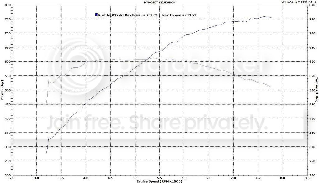

Not bad for the 4th pass the car has ever made! (first 3 being stock)

Well, in the interest of not oiling down tracks.....I have decided to do a quick engine upgrade.
The car is making so much power right now with the VMP Gen II....I am really nervous about trying to push OEM parts so far.
That said, I will likely be throwing a new shortblock in that consists of an FRPP Engine Block, Mahle Pistons, Manley Rods and a new stock Crank.
I may use the stock stuff (pistons/rods/crank) for a project side build, high RPM N/A type deal.
Oh come one Kelly. Everyone on the 6G board knows that the S550 Coyote is safe up to 1000hp.:roflmao:

Damn Kelly, that was pretty uneventful for a 10 flat. Like walkin the dog. Sweet. Is that on the stock converter?
