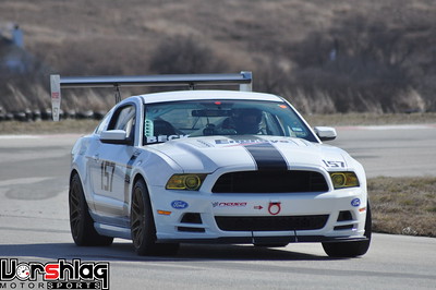

We ran the same car on 18x11F/18x12R (left) and 18x9 F&R (right) at different times, but the outboard track width is similar
Therefore I highly doubt that you have a 265mm tire as close inboard to the strut as we run with the 18x10 or an 18x11" wheels. Strut diameters/widths are very similar among all strut styles and brands, by the way. We ran our S197 on 18x9's and 265mm tires (above right) for a long time (2010-2012, restricted to those limits for SCCA STX class) on several sets of 18x9" wheels - but each set still pushed the track width out as much as possible, which made for massive inboard tire-to-strut clearance on this skinny wheel setup. With the 18x10" if got much closer, and the 18x11" (above left) it was down to about 3mm clearance from inside of the wheel to the strut. Very very close. There's also slop in the strut bracket-to-spindle bolt holes, which we have to maximize for the 18x11" front wheel fitment (pulling the spindle outboard to maximize inboard wheel room).

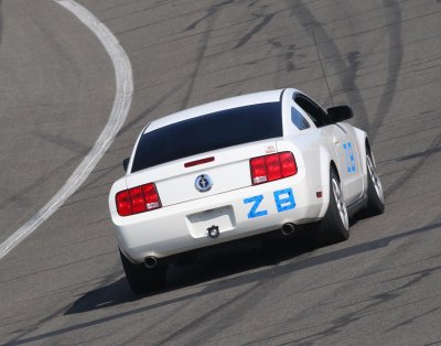

And the "early" and "late" S197s are virtually identical. They share the same strut towers, lower control arm lengths, strut diameters, and fender clearances. Jon @ Vorshlag's (see above) "early" S197 has our 18x11" wheels on 295mm tires, and he's about to switch to 315s. They fit under stock fenders of his 2007 GT almost exactly the same way they fit on the 2010-14 cars.
