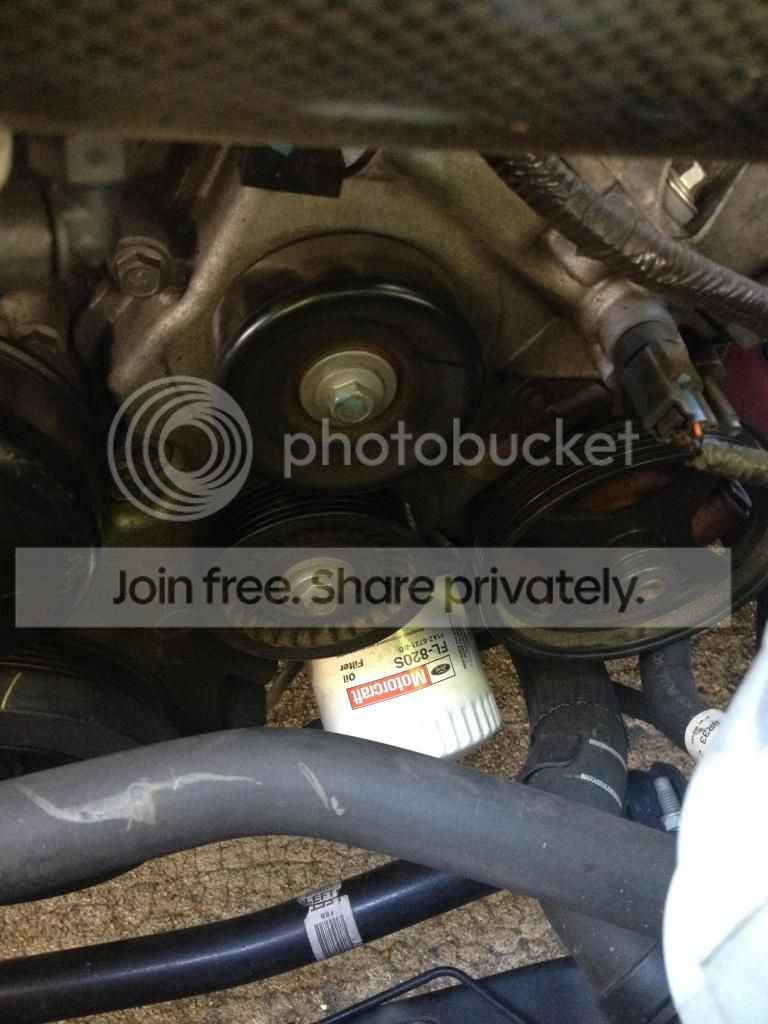

I think I found the culprit. I started the engine with the belt off and it didn't make the sound. Then I spun the pullies by hand and found one that makes a weird noise. I took a picture and a video of it. Now what do I do to fix it? Replace the pulley and which one am I looking at. Thanks for the help
(it's the one on the left just above the filter)

Thanks guys. I'm going to get it from my local stealership Steve since they actually have it in stock. But I'll keep ordering all my plan in advance parts from y'all
Can I reuse the existing screw set. What's the torque spec?

Yes, bolt is reusable... Torque to 18 ft/lbs.

Well I got that one replaced. It was for sure bad but there is still another one that's bad. Sound is still there but better. Since spinning them only turned up that one I guess I'm going to try and listen.

Of course! :) Without the belt only the crank pulley would be spinning so you wouldn't hear any sound from the other pulleys. Glad you found the culprit was a bad grooved idler pulley which is cheap and easy to replace.
Good idea but do it with the belt in place this time. ;-) I'd be willing to bet that the culprit is the other smooth-faced idler pulley above the grooved idler (another cheap easy fix).
