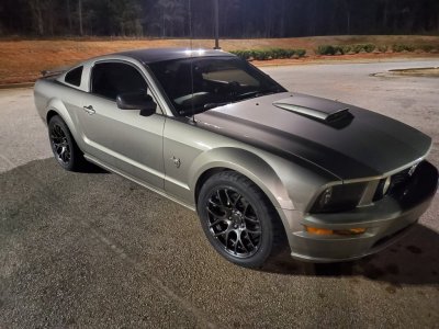

I have been going back and forth on what tires to put on the GT500 forged rims from 2010, which are 19x9.5. I have 2008 GT with a TVS.
So I can rotate side to side I went with the Nitto 555 G2. All around capable street tire.
285/35 on the rear, wanted the most tread width that will be the right fit for the wheels.
I am looking at either 275/35 on the front or 265/35.
The 275/35 keep the diameters closer together, fronts at 26.57 and rear at 26.89
The 265/35 would be 26.34 and rear at 26.89....
I guess the questions are, should I just go 275/35 squared, what's the real difference 285 VS 275 in width...not much. Or 275/40 squared?
Is the diameter matching that important?
I know I want more meat upfront compared to the original tire size of 255/40 and I wanted the largest for the wheels out back....don't want to use spacers.
Any feedback??

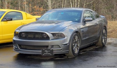

I have a 295 on my 10 in wheels and they look pretty good. This is the best picture I have right now. 295's square.
