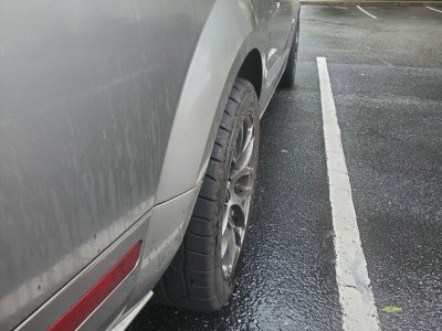

I'd just square it up with a nice 285/35/19 tire all around
So no rubbing issues on a 2008 with 285/19 ?? The 285 does look like a perfect fit with the original good years, I understand Nittos run a bit more narrow.
Dont know for sure yet, but I believe it will not rub. 275 19s had plenty of clearance. I may need a small 5mm spacer in the front, but no more than that.
The wheels are Boss 302S rears on all four corners. 19x10.
I am waiting for a nice warm day to mount them and check fitment. We are still getting colder than seasonal weather.

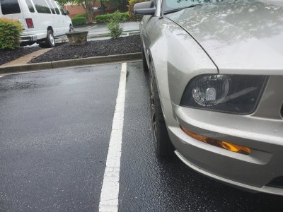

OK Aero, those look like the Goodyears, is that a 285 Square Set Up,
And how much is your stang lowered?
I have the Steeda Sport Springs with Koni Yellows..

Correct. They are new take-offs (stored 10 years) OEM 2010 GT500 wheels/tires, just as they came mounted from the factory. I had multiple sets and am running the rears (285's) from 2 sets to go with the square fitment. I am not sure of the total drop, but it's pretty significant, especially with the lower body kit. It rides on adjustable Eibach Pro-Street coilovers.
It's a bit lower in the front and quite a bit lower in the rear compared to Steeda Ultralites on another S197 I own. According to Steeda.com, your Sport Springs do not lower as much as the Ultra-Lites, meaning, you should have even more clearance than I do.
And thanks! :)
For comparison, the dark car is on Steeda Ultra-Lites, which are lower than your Steeda Sports (per Steeda.com). You can see how much lower the silver car with the square GT500 square set-up is, and I've yet to have any issues. YMMV.
