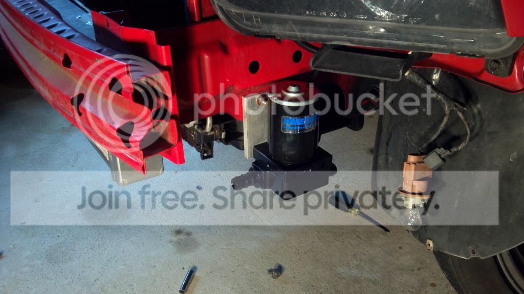

Where did you guys mount that heat exchanger pump and how? if I can get some pictures that would help me out a lot thank you

You would probably do better posting this to the dob site. I followed the Roush instructions and mounted driver side front bumper area. We fabbed up a bracket with rubber insert to make a mount.

If you are using the factory GT500 HE and the factory pump than it mounts on the HE. Here is where I mounted my meziere unit.

It depends on what HEX and pump you are running. Variations can drive location to driver's side, passenger side, or front center (near horn) location.
If going hard-core...pay up and buy a Mezeire.
+1 we even have a tank in the works that mounts the Meziere pump to a tank that goes where the OEM battery goes.
