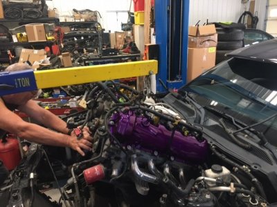

I have a set of new kooks headers and an x pipe that I was going to install in the spring and luckily my friend was going to let me use his lift. The mustang is in the garage for the winter and I'm getting the itch to work on it... Do you guys think it would be best to wait until spring when I can use that lift or do you think this is worth the time and effort of doing this in the garage on some jack stands? If I do this on jack stands what are some tips to save time and anger?

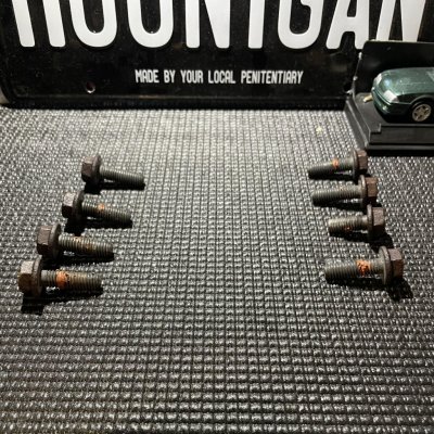

Also, the car already has bbk long tubes and the studs that attach the headers were replaced with bolts, should I get OEM studs or reuse those bolts? I already soaked these bolts in free-all incase god forbid one snapped.

I've heard of plenty of people doing headers on jack stands before. I did it in my parents driveway to my '66 back in high school, lol. I love everything about my lift though and can't imagine doing certain stuff on the ground anymore. Depends on how back you want to put them on I'd say. Get the car as high as possible, loosen motor mounts so you can jack 1 side up, or move the engine over a little, for clearance if you need to.
If the bolts are still working, I'd just keep em, no sense in fixing something that isn't broken. Are the kooks flanges thicker than the bbk ones? Bolts might not be long enough. Only issue I could see running into.

Thanks, I didn't even take that into consideration with the bolts. I'd guess the kooks has a thicker flange but I don't know so I'll measure it when when I get home.

Being that you are going to need to remove the engine mounts (that bolt to the engine) to get to the bolts that are right above them. Then you are going to need to remove the steering shaft to get the headers in.... you are going to need a way to support the engine while you do this.
I got lucky when I did mine as we had the engine out doing a manual trans swap, and we just took the steering shaft loose and dropped the engine back in with the headers already bolted to the engine.

You can jack the engine up with a floor jack after removing the mounts. I replaced my engine mounts with steeda ones while I was in there. I don't remember the steering shaft removal being that hard. One of my primaries rubbed on the steering shaft. I tried everything I could in the car, but ended up have to remove that header to dimple it enough for clearance.
Half of the bolts are reach from the top of the car anyways.
Just depends on if you wanna do the lower side laying down or standing up, lol
oh, A flex head wrench is A MUST when doing this job. On the coyote that is, but I imagine it's similar on the 4.6

I installed Kooks LT on my 05 with jack stands. Things I remember; you will have to loosen motor mounts to raise engine slightly. Loosen steering rack and remove drivers side bolt so it can be moved forward so steering shaft can be moved out of the way. The bolts holding the BBK have to be removed/loosened anyway so might as well replace them with proper fasteners.

Yesterday I sprayed all of the upper bolts with free-all and didn't do anything else. Today after I got home from work I jacked the car up and sprayed all of the lower bolts. I then said fuck it and pulled the starter while I was under there and then removed all of the upper bolts. I'll be removing the rest tomorrow after work. If something comes up I'll ask you guys for advice. I made up my mind and I want to do this in my own garage.

In that case I'll be ordering all of the factory hardware for sure. The headers came with metal gaskets, do you think those are ok to use or would my best bet be to go factory? The last thing I want to do is have to pull the headers off again just to put gaskets on. I have one more question regarding the header gaskets, I should've took a picture while I was in there but I noticed what looked like orange rtv squeezing out of the sides of the manifold gaskets... it was also on the threads of the manifold hardware. I'm guessing that this is Permatex high temp gasket maker, is this really necessary to prevent leaks?
That depends on the type of exhaust gaskets being used........some also just use it as a precaution to ensure that no exhaust leaks occur because these are so much of a PITA to R&R............. Some use a copper-infused spray sealer to do the same task as the Permatex.....
Why most recommend using the OEM multi-layered metal exhaust gaskets if at all possible, but some header companies do provide good gaskets w\ their products.....but not all.
In the end your decision.....IMHO it doesn't hurt to use it if you want to.
