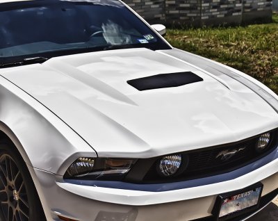

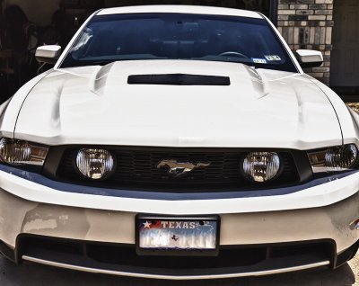

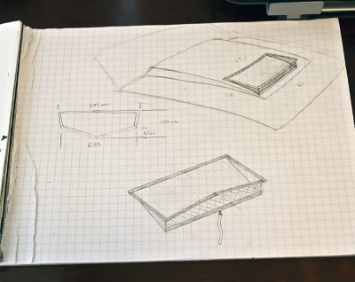

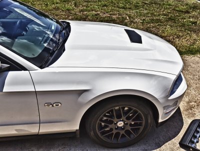

New direction today. Since we are dealing with a more narrow cowl, I think a single extractor like the newer GT500 is a better bet. After spending a lot of time looking for a generic extractor vent and finding either super cheap, or very expensive pieces, I think making my own is the way to go.
I'm thinking that .100" 6061 aluminum sheet would be a good bet. I can use a sheet metal break to shape the pieces, then weld it together, and either paint or powder coat it (black, or even white). I can taper the flange thickness so it blends well into the hood, and secure it with small rivets. The hood is aluminum correct? So I won't have to worry about different expansion characteristics.
The actual vent portion will be vertical, or even inclined backwards, with an integrated catch lip and drain tube, to direct water when the car is parked in the rain.

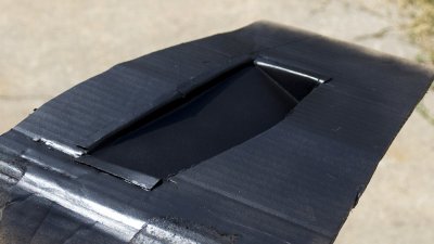

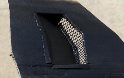

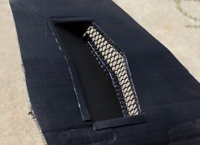

I had some 1mm aluminum laying around so I built a dirty 1/3 scale mockup. Trying to brake such a small piece on my vice was a huge pain. It will no doubt be easier on the full size version, with a proper brake. But I'm thinking that making it out of more separate pieces and welding will be a better idea. Especially for the flange since it has to match the crown of the cowl. This model is missing a front piece for the flange.

kgrun4
Jul 15, 2011
308
Albany, NY
Looks good, keep us posted. It will be very cool if you end up creating your own.

I made a small model out of paper too to test some of the dimensions

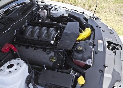

I'll probably just cut through the hood, bracing ribs, and blanket in one shot with my jigsaw. You can get a decent look by just tugging on the blanket and peering under it.

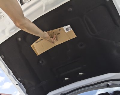

Yanked the blanket to have a look at the bracing and it's good news. Man too bad those front pockets are too far forward to do much, cause they'd look cool!
I think that even if I go to my full intended width, the bracing removed won't compromise strength.
