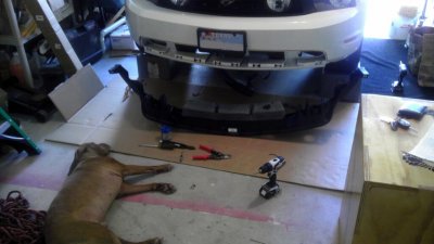

Side project today: CS front clip installed. Much better!

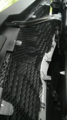

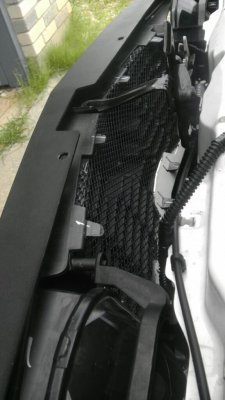

I installed mesh screen in the lower and upper openings to keep the condenser from getting beat to a pulp over time. And as you can see, I've opened up the rest of the honeycomb.
Helper hard at work...

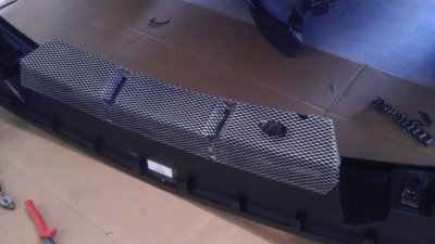

First I tried a nice sharp utility knife to cut the majority out, but eventually I used the dremel for everything... A small carbide cutter to hog most of it out, then a small barrel sander to clean it up. It's easy to hit the chuck on the front of the grille and mar it. It's not super clean on the inside of the honeycomb, but from a step back you can't really see it.
