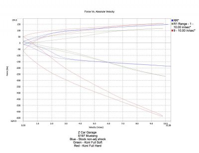

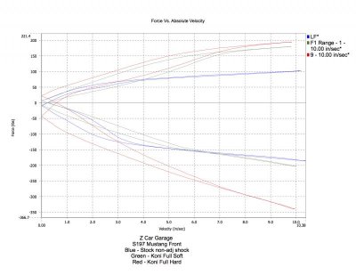

Aaaand.... for those who are interested, I got the dyno plots back for the stock Track Package dampers.
Front:
(PDF: View attachment F Shock.pdf)
Rear:
(PDF: View attachment R Shock.pdf)
I don't know if their plots of the Konis (full soft and full hard) are accurate or not. I'd have to compare them against the original plots. I'm interested to see what people who know how to read these things better than I can think about the differences.

The Koni plots look to be reasonably similar - though I only looked at the max trace (the light green min trace is too faint for me to work with at least on the screen, but I think it's pretty close to the OE curves).
What I think I'm reading is that the OE rebound curves head off toward a better ride/less control compromise at a little over 2 in/sec, which is likely where a stiffer than OE spring will operate at least more frequently.

I provided PDF files that might prove easier for you to examine. If that's what you were looking at already then I can probably manipulate the images to change the green color to something easier to see. Just let me know if that would be helpful and I'll be happy to accommodate.
What's interesting is that the Konis ride MUCH better than the stock dampers. The stock dampers made small impacts feel "rubbery" or something. Maybe because they underdamped the higher speed motions? If that's not it, then I suppose it's possible that such a thing won't show up on the dyno plot, which would leave me wondering how one can derive the ride quality from something that is objectively measurable. After all, ride quality is in the end just a matter of physics (here, minimization of cabin motion over bumps, though the passenger's sensitivity to that motion surely varies with frequency).

The .pdf's are a lot easier to read. For quick looks on screen maybe a dark green would work better here (17" HP touch-screen capable laptop, if that matters).
Those aren't the only kind of damper plots. Force loop plots might be useful to have.

Fixed.
I'll see if I can get the raw data for these. That way I'll be able to generate whatever plots I want, as well as supply the raw data to you guys so you can analyze it however you like.
