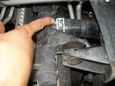

Update,screw those radiator hose clamps,get the regular kind screw type,realized this after 4 skinless knuckles and a pinched finger....

its easier from under the front of the car
