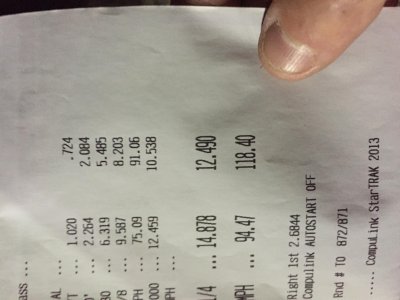

Yeah, it was great air that night despite the track surface being a little cold.
Thanks! She definitely pulls hard once I'm in the top of 3rd gear and all through 4th. My gearing and tire height are perfect right now IMO. 1/8th I'm passing through the traps around 7,100RPM in 3rd. 1/4 mile I'm passing through the traps around 6,900-7,000RPM in 4th.
How are you reaching 7100? My car shits itself at 7k and cuts fuel.

Your car sounds excellent going down the strip! Good run, especially the trap. I'd be looking into a set of dedicated bias ply slicks to throw on when you get to the track. Alot of 03/04 Cobra owners were running good times and kept the stock IRS living decently while running bias ply slicks. Most of them swore the flex in the sidewall took alot of the shock away that drag radials and street tires put on the half-shafts. I think a little pre-load with the e-brake and slight engagement of the clutch is a good idea as well, prior to launching.

Thanks! I'm not going to run slicks. As I mentioned before I drive my car on the street frequently and like last night, I got caught in some heavy rain headed home. I need a tire I can run on the street and handle decent in rain when need be. E-brake? No, I just need to find the right pressure and rpm to get a good 60'.
