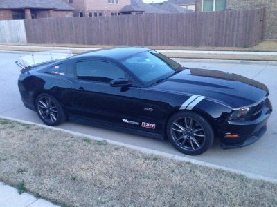

Here's my potato camera photo of the ridiculously huge spoiler on csamsh's car.
claudermilk
Jul 12, 2012
1,840
SoCal
That'll create some downforce.
So....does it pop a wheelie when you go fast enough?
