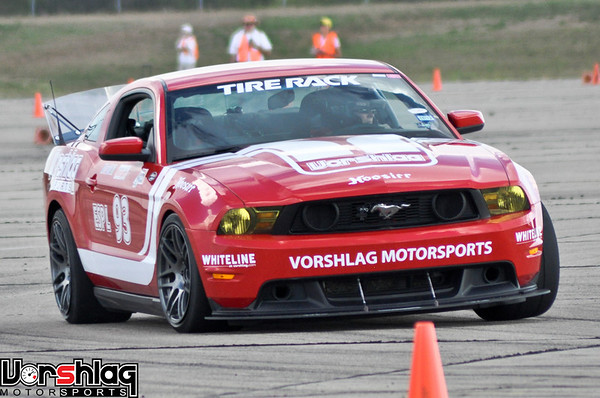

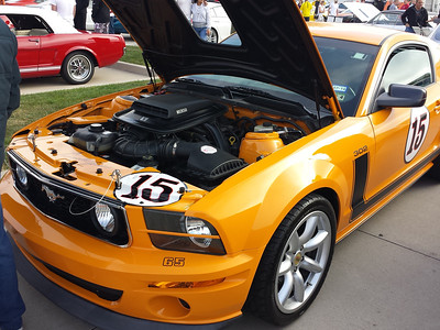

You need to ask yourself, honestly: do you want to Hard Park (left) or really push the suspension (right)
It really depends heavily on what you plan to do with the car. If its only "drive it to work and park it at car shows", then get the shiniest doo-dads you can find. Some people would just rather spend money on inappropriate or unnecessary parts than plan for their suspension for the intended use, maximizing their money spent on getting better lap times (aka: results). I get that "spending money on shiny parts" is fun for most of the Mustang aftermarket. Probably 98% of all suspension parts sold to "Mustang people" is for looks.
