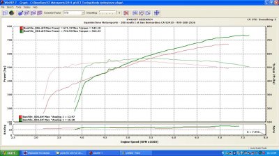

Kenne Bell 168mm t-body tests
Ok guys, sorry for the delay on the update, Im just very busy with work,we are busy. Finding the extra time to surf the net, put all the data together with a description has been hard to find.
Testing for the Kenne Bell 168 mm t-body. I only tested with 2 pullies, the 3.5, and 3.25.Pre throttle body, With the 3.5 pulley, I was seeing 11.2 lbs peak, and a best of 623 rwhp and 502 rwtq. Just installing the throttle body, we saw the boost increase to 14lbs peak with a peak HP of 702 rwhp and 514 rwtq .
ALL TESTING AT THIS POINT WAS ON 102 OCTANE.
3.5 pulley results:
Stock t-body peak power was 623 rwhp 503 rwtd @7100 rpms.Note stock t-body is falling off at 7100 rpms. Shows signs of restriction at just 4000 rpms.
Kenne Bell 168 mm t-body peak power was 702 rwhp and 514 rwtq @7600 rpms (was still climbing)
The gains at 7100 rpm were 54.17 rwhp and 40.15 rwtq. This rpm range is used for comparison, as after 7100 the stk t-body was so restrictive, power was dropping off quickly.
Peak gains overall were 79.18 rwhp and 10.97 rwtq because of less restrion and the ability to run the car higher rpms without dropping power. I was considering running the car to 8000 , but couldnt force myself to do it yet and as you can see power was starting to drop. I could have possibly worked with valve timing to help, but 8k is alot for stock. Ill save that rpm range for the forged block.
Peak boost gained overall 2.8psi. The boost increase isn't due to an increase in blower speed, but a decrease in inlet restriction. Less restriction = Less parasytic loss > MEANS MORE HP.
3.25 pulley results:
stock t-body peak power was 671 rwhp 543 rwtq, peak boost 12.97 lbs @7200 rpms
Kenne Bell 168mm t-body peak power was 732 rwhp and 564 rwtq 16lbs @7500 rpms
Gains at 7200 rpms 44.84 rwhp and 35.16 rwtq
Peak Gains total 61.56 rwhp 21.13 rwtq
Peak boost gained overall 3.3 psi
So one question I would expect..why so little torque gain PEAK?? Well at the lower rpms where boost first comes in and the torque curve hits, the t-body ins't as restrictive. Once you get up in the rpm band, you see the restriction, as the stock throttle body run loses HP and TQ. The HP and TQ curves continue to climb with the Kenne Bell t-body. You will notice how much more linear the tq curve is as well. The Kenne Bell will continue to make power with RPM as long as it can breathe. Here is the dyno sheet.
One more nice thing about the tuning on these cars..valve timing. There are some nice gains with VCT to had, along with the benefits of getting the boost out of the engine.
Attached is the 3.25 pulley graphs.Thanks for reading and More to come.... Thanks Adam
