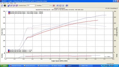

Regarding the Innovators West balancer. While running the last tests, I wanted to achieve more boost without having any belt slip issues . The best and easiest way to do this is overdrive the crank, and keep a larger pulley on the blower. So we purchased an Innovators West overdrive crank balancer which by calculation should have been good for 3+psi. Stock crank pulley is 6.6 in, the new IW crank pulley was 7.5in. We installed the crank pulley and made a few pulls on the car to see where we were at boost wise. As expected we saw 3psi peak. After the few pulls, I began working on the torque tables for the bigger Kenne Bell 168mm t-body. Using the brake on the dyno I was applying load to the car running the rpm consistantly from 1500-4000 light to moderate throttle to mimmick cruise and light accel. While on the dyno,just cruising at 3k rpms loaded on the dyno , I heard a ding ding and looked at the gauges.NO OIL PRESSURE. Shut the car down, and called it a day.
Came to work Monday,checked the car,verified no oil pressure. Pulled the engine and found a broken oil pump(knew it already,just wanted to confirm). Called Ford ordered a oil pump next day air, got it Wed. Pulled the engine, installed the new pump,re-installed the engine and hit the rollers Friday morning. Made a some light pulls on the car at med throttle loading the car to finish the t-body tuning. Was satisfied with the throttle response and manners, so it was time for a pull. First pull at 7 k...ding ding..oil light back on. Turned the car off but the crank didnt survive this round.
WT#@$*!!! The only thing different here is????? THE OVERDRIVE PULLEY.
I have run the car at 14-16lbs of boost a ton with ZERO issues. The boost with the new balancer was never over 11lbs, as I was reworking the throttle tables for drivability. Bottom line , the crank driven oil pumps CAN NOT handle harmonics , and the balancer defintely wasnt doing its job. I have beat the hell out of the car on the street at 710 hp without any issues. Again, the only thing that was changed was the balancer and this was the first failure.
So now I have an ATI balancer for the car, along with forged internals. Looking for some solid numbers and ETs here in the near future. we will be dropping the engine back in next week, and Ill finish my 2.8 testing, and will be installing the 3.6LC. My prediction...Street driven with perfect manners, low 9 sec ride , full street trim.
Ill get some more updates after next week with the rest of the goodies. Thanks Adam
heres the dyno fo the 2 4in pulley runs with both crank pulleys.
