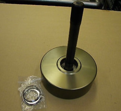

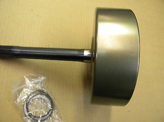

No screwing around with this TH400. Since it wasn't what it was supposed to be and we had to buy some hard parts I splurged and ordered $2,500 worth of some nasty 2k HP billet parts and Alum drums that will remove over 8lbs of rotating mass! Worth a few hp and over 1tenth in 1/8th mile alone.

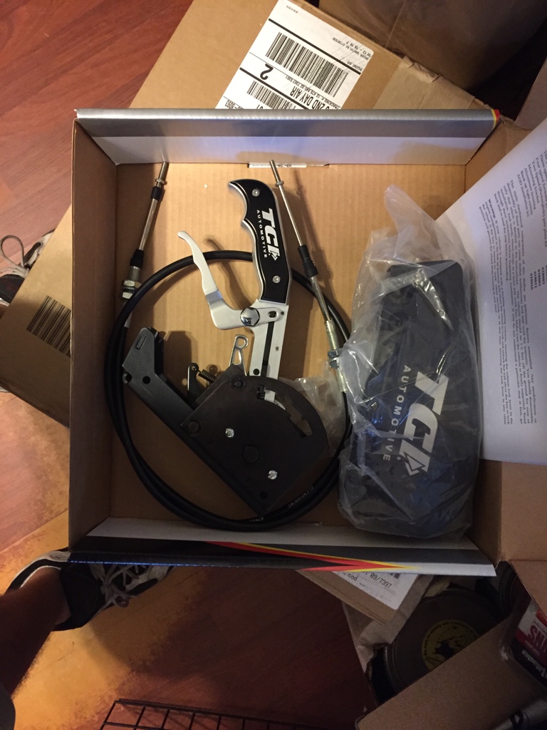

im getting ready to put a order in with summit to get all I want beside trans, ds and converter. Where u get those th400 parts and and the 8lbs losing would be nice. Also what shifter is that is it ratchet as im thinking about getting a ratchet shifter. what u think about those or why did u get the tci one?

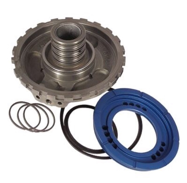

I ordered a lot of the parts like the pro-mod alum intermediate drum from TSI(transmission specialties) the 7075 alum front drum with billet alloy input is from Coan transmissions. ATI makes some nice billet drums as well.

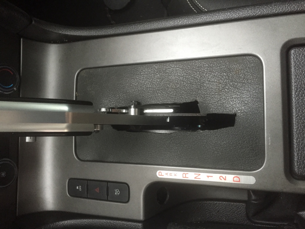

I prefer pistol grip shifters. I have used the Hurst Quarter Stick many times and it is very close to the TCI Outlaw but I wanted the black handles to match my interior better.

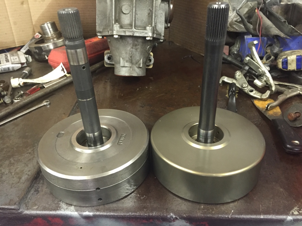

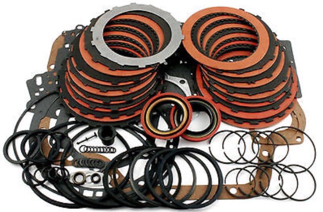

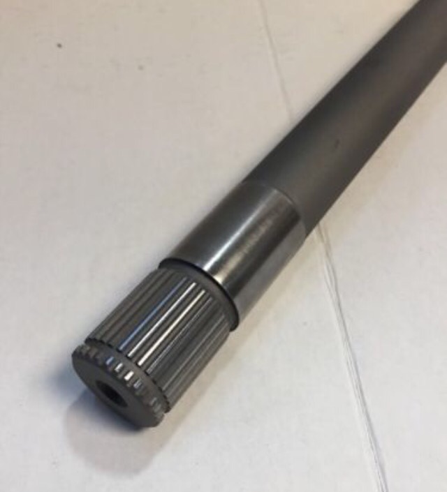

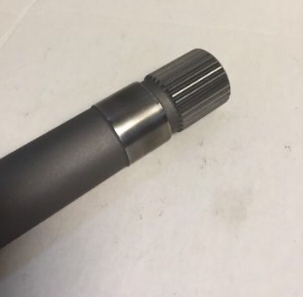

Well a little update I got the transmission built

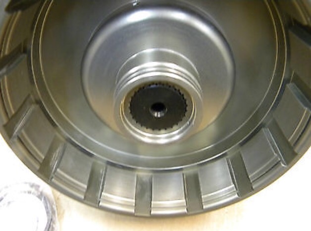

One of the aluminum drums I used. notice him much larger the input shaft is now and the splines.

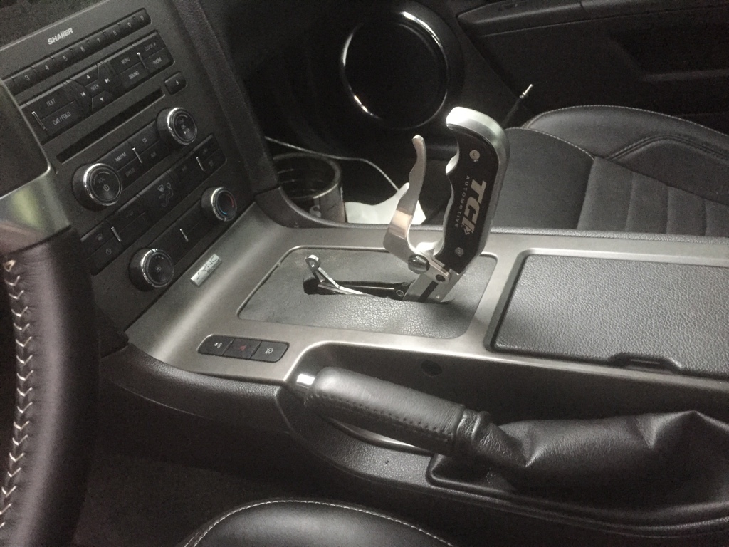

New shifter is mounted

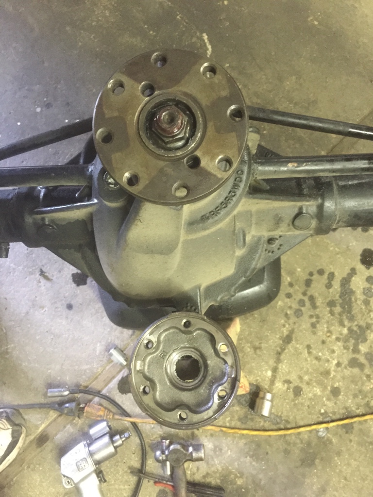

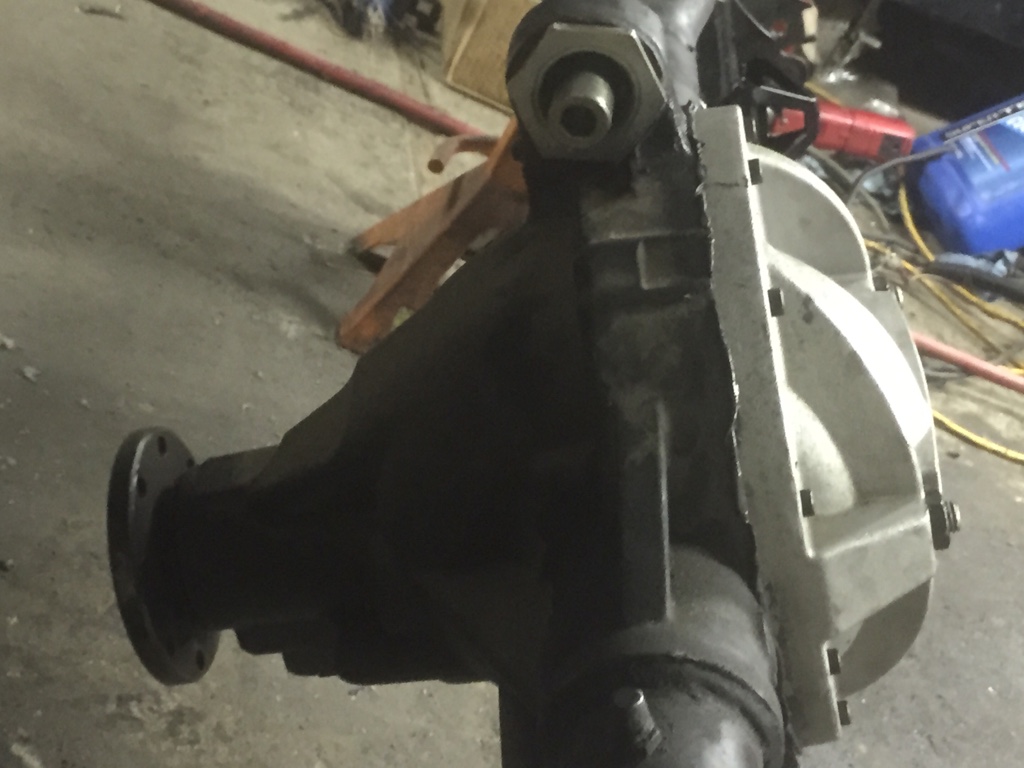

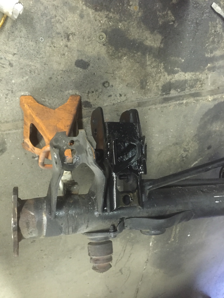

Doing a little work on the Rearend finally
1350 style Cobra pinion flange swapped over.
Spool
Girdle back on

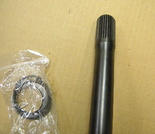

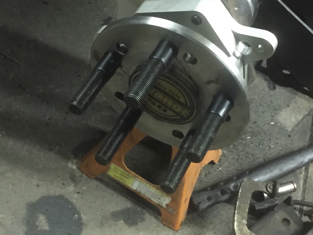

Tiny 35 spline axles and 5/8" studs
Axle tube weld been holding up for over a year and a half of beating on big sticky tires [emoji39]
Lca relocation brackets filled in solid to factory brackets and gusseted.
Added tie-down strap rings to back of LCA brackets to make tie-down on trailer quick and easy.
