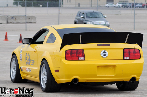

As for "STP is just ESP without the fun" (ie: on street tires), I think you should re-read the ST and SP rules, as there are massive differences in class rules/prep limits (which can add up to $30K+ in cost differences between a top prepped STP and ESP cars for the same S197 model). Other than the hood and rear wing, our 2011 GT (above) wasn't that far off what a winning ESP car should look like, as far as prep. Big dollar shocks, bone crushing spring rates, low and legal length splitter (lop 2" of length off that one above), wide fender flares to house 335/345mm Hoosier A7s, Torson T2-R, lightweight racing seats. That was roughly a $90,000 build...
To be maxed out for ESP it still needed the A/C ripped out, no roll bar, no rear seat (Laguna Seca kit), wider wheels (18x13" rear), super-light autox only brakes, a forged bottom end Boss302 long block for higher revs, maybe a different intake/TB, 450+ whp, 10" rear spoiler (circa 1960!), an uber-light flywheel and triple disc clutch. And new tires 3-4 times per season. Money money money. I've run against 7 time ESP Champion Maddarash many times and he didn't mess around with using scrub tires or skimping on prep.

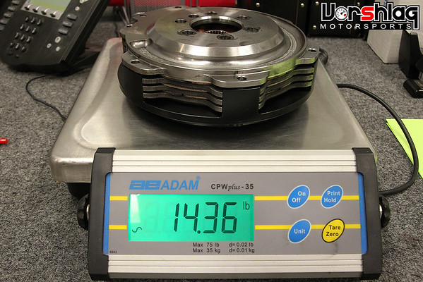

This 7.25" triple disc setup and its 14 pounds with the flywheel. The 5.5" units are lighter still
Driving a full prep SP car is a real chore. The clutch is the worst part - its an on/off switch and you will stall it often in the grid, and NEVER want to drive it anywhere else. It feels great on course (as my 7.25" triple does in our TTC Corvette), but its a nightmare to use anywhere else.

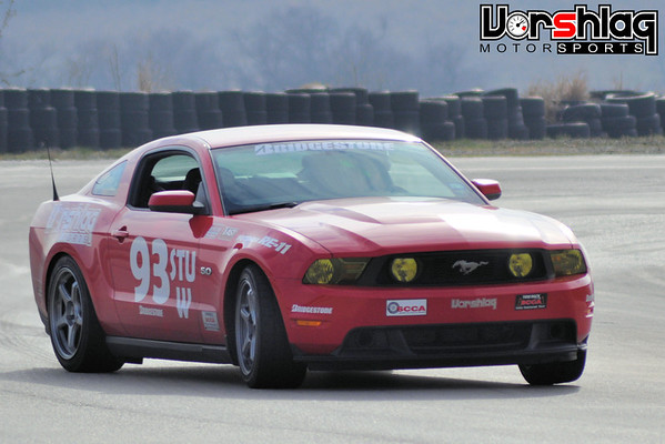

When we had the car in STX and STU trim, Amy still daily drove her Mustang. It rode great

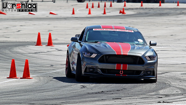

Shit this thing is a smaller splitter and 2wd away from being a legal CAM-T car:
