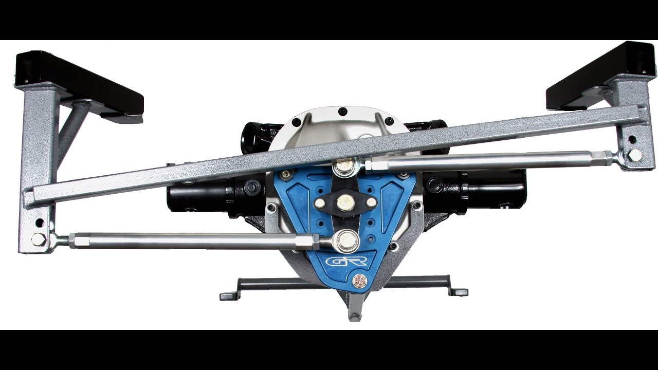

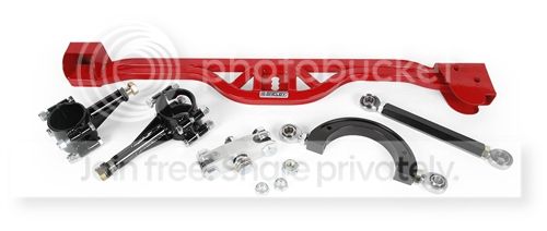

I don't think you're interpreting what Jason said in the correct manner. Rather, think of the main component of the chassis mount watt's link- it's triangulated and spans the frame rails, or in the case of the BMR, is a giant boxed beam. It could probably be successfully argued that it gives more chassis rigidity than the stock piece, or the single-bar type pieces with the diff mount style. That being said, there are a lot of chassis mount watt's out there, and I personally think you get to kick your protester in the dick for protesting that, but, by the letter of the rule I can see how a chassis mount watt's could be construed as chassis stiffening.
The large red piece is much more substantial than the same piece on a WL,
Fays2
BMR
WL
GR
Cortex
