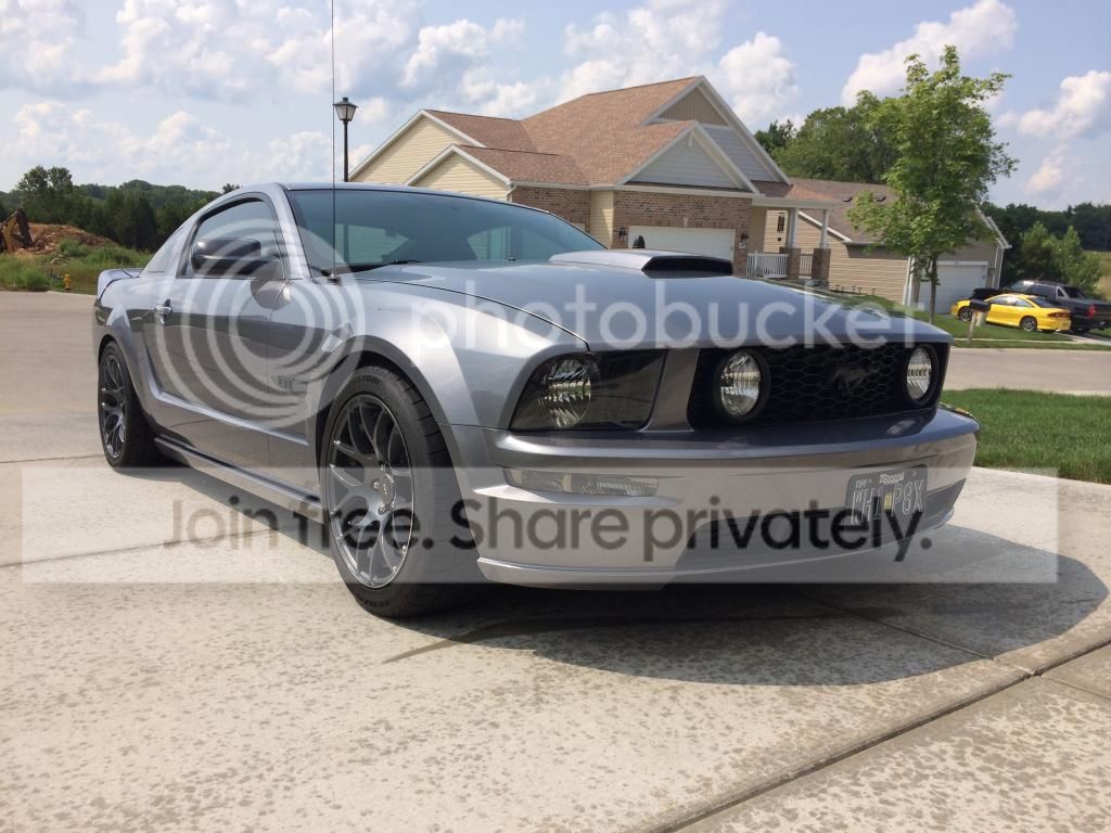

Here is my 18x10 square setup. Bridgestone re760 sport 275/40 front 295/35 rear, love them in wet and dry and great cornering. Affordable cost also.
