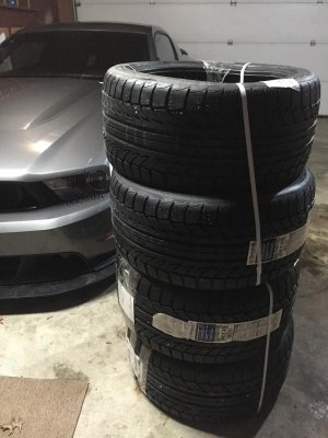

Good stuff. :thumb: How have you been liking those BFG's?
I really like them, I'm much more satisfied with them than I was with my Hankook V12s, I had way more confidence in the tire. I noticed it most in the slalom. They will really get put to the test on June 4th at the track day. I ran this track last year with my Falkens and the year before with the Hankooks.
