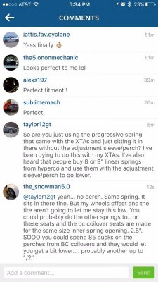

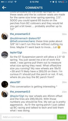

I didn't get a chance to pull the rear springs this weekend, but out of dumb luck one of the guys I follow on instagram wanted to pull his perches on his XTAs to get a little lower and did so without any problems. He stated they were in fact 2.5 ID springs at the base so that's good news.
He also said if you're looking for a little more adjustment without swapping springs. Then you could go with the BC Racing rear spring adjustment sleeves/perches. They are 85 bucks and allow for another 1/2" of adjust-ability. I haven't called BC yet today to confirm.

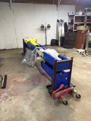

She arrived today. Ignore the messy shop, it's a work in progress.
