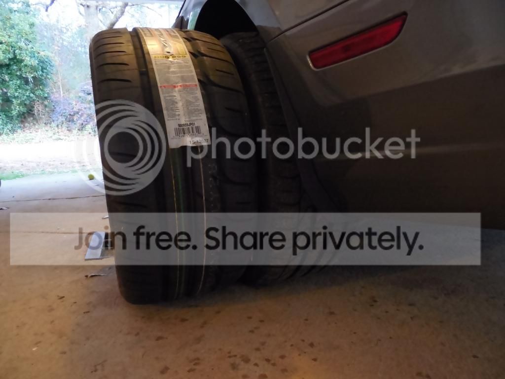

square 18x11 norm?
Yes.
attachment.php
Norm
