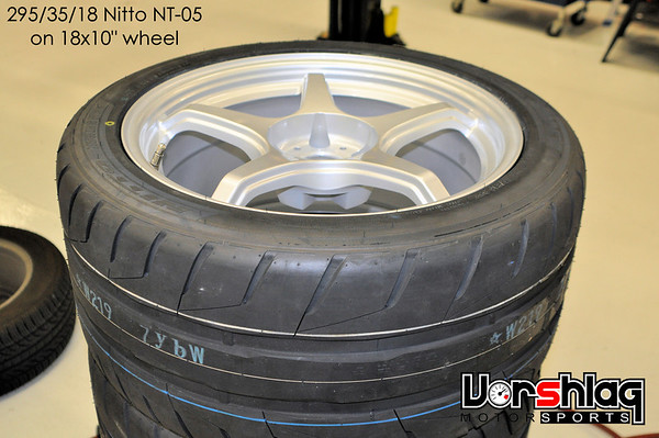

We always tell people to NOT base any testing / issues / problems on old junk tires. At least with a new fresh set of NT05s it sounds like you have 4 new tires now, so the understeer might have been there all along. And while I'm not the biggest fan of the NT-05 tire, at least its a 275mm and fresh - which is better than most "random folks" in S197s we see at the track. :)
Definitely run a rear anti swaybar bar... the S197 cars will almost always push without a rear bar (every single one I've driven w/o a rear bar was an understeering pig). Yes, there's a dozen internet experts that will pop up saying "no bar is best" but as soon as you ask them "what have they won?", they tend to shrink away. :whistle1:
I like larger, adjustable swaybar at both ends, which I use for tuning and some roll control. Then proper spring rates and real dampers to get ride of the rest of the roll and all of the squat, dive & heave.
There is no magic swaybar or "formula" that works for everyone, but a set of bigger-than-stock bars with several adjustment holes tends to work for most folks. Lots of variables go into picking the spring rates, camber settings, tire pressures (500psi!), and other variables (like shocks and spring rates) - which depend on the tires, competition use/level, roads/tracks you drive on, etc.
