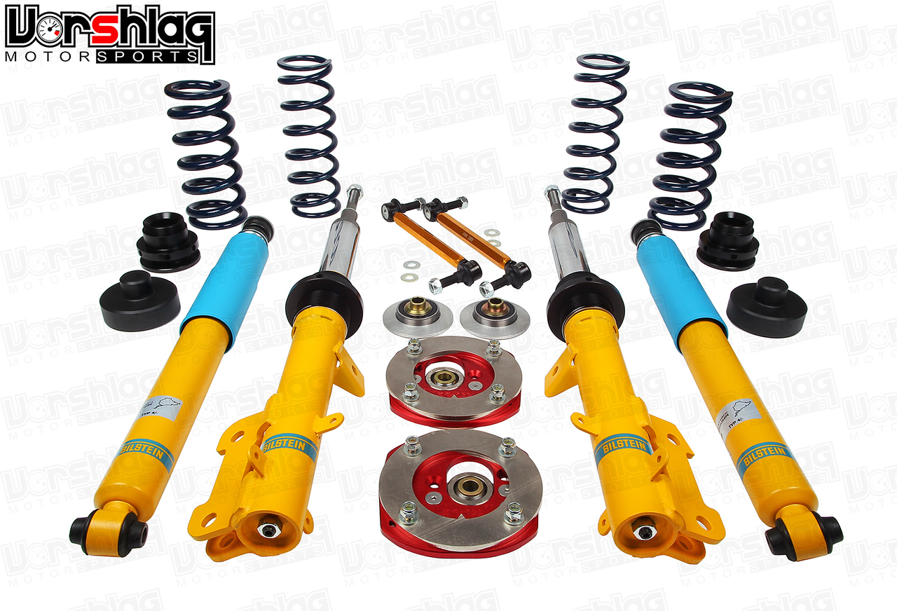

2. MCS TT1 Single Adjustable Dampers with Hyperco Springs and Vorshlag camber plates - $3,650 <-- This is the one I'm leaning towards as of now
3.Vorshlag-Bilstein TrackPro Monotube Coilover Kit - $2,500

Honestly if you are going to DD the setup I would go for the Biltsteins.

Ditto. The MCS may not even have an anti-rust coating since they are more of a race coilover.
Although, I must say it... you can buy some standard Bilsteins, lowering springs and camber plates and duplicate the Vorshlag kit for about half the price if you don't need adjustable height.

80 miles a day commuting? I wouldn't go with "high-end" dampers; they're most likely not designed to deal with the harshness of everyday driving. Of those three choices, I'd go with the Bilsteins.
