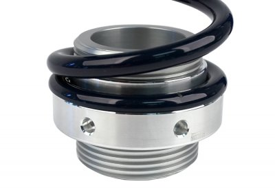

Installed these Steeda Rear Ride Height Adjusters. They allow you to "obviously" raise or lower your rear ends height. They also allow you to be the one who decides what rear spring rate you want to use and how tall you want the springs to be.
Little tip, go with 10 inch tall springs, regardless of the rate you use. I was informed that you can go with an 8 inch spring with a 350 lb rate. That proved to be too short and the fenders are just about kissing the tires at its tallest setting.
