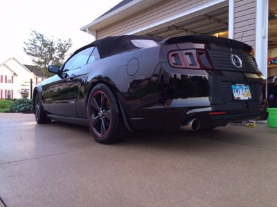

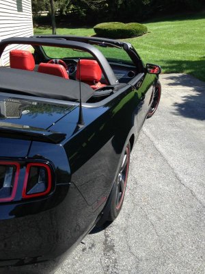

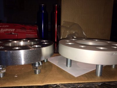

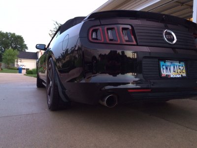

Sorry for the delay - I got the spacers on. the expensive ones and the cheap ones were the same thickness. the studs were the same. the only difference is that the Eibach had a blasted look to the surface finish and they were a larger diameter. The cheaper billet ones matched the exact diameter of the hub and inside of the wheel.

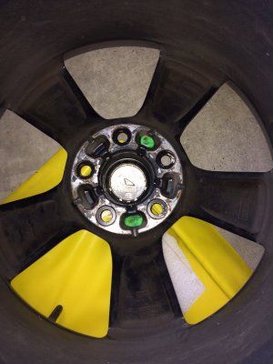

The factory rims DO have pockets for the wheel studs to fit into, so they both would have worked without having to trim the stock wheel studs. I wasn’t sure how deep the studs would fit into the wheel pockets, so I put a little green playdough in there to see. There is still about ¼” clearance.
I made sure to clean the studs and all the rust as well as remove the thin washer that was holding the rotor on the hub.
Sorry for the dirty car – it rained every day for a week.

They are 1" thick. I tried the 1.5" and the wheel stuck out too much. Looked like the cars in high school when they stuck a 50 on the rear of their Camero.
With the lowering springs, the wider spacer would have caused the tire to rub the fender and I don't think that rolling the fender would have helped.

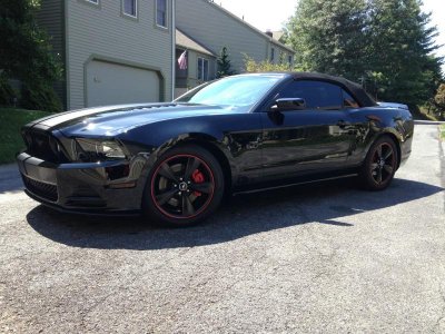

OK - I went and put front spacers on.
They really look nice. This is one of those things that 99% of people wont notice, but once you see it, you can not unsee it. I think that lowered cars need this more then stock height cars.
I had to trim the stock wheel studs in order for the front wheels to fit. I did have my wife hold the front brake while I torqued the nuts.
When I was done, I checked the rear spacer bolts. All were tight. I did have two slightly loose rear wheel lugnuts. But I also didn't torque them down with a torque wrench as I didn't have the proper size socket. All are torqued now.

Is that a FRPP Boss 302 leguna seca splitter under the cdc front spoiler....or it made by cdc ?
Rusnak_322
May 21, 2014
27
Thanks, I can’t take credit.
I bought the car as it. I found it on ebay and contacted the seller after it didn’t sell. Turns out he was out of the country and the car was in storage. He was moving his wife in less than 2 weeks and if the car didn’t sell it was going to sit for 2 ½ years until he returned.
The owner was well off and in his mid 60s and paid someone to have the car murdered out. When I picked it up, there were more mods then he knew about. I got all the stock parts except the O2 sensors.
Lowered with adjustable bar and alignment
Matte black stripes and GT side stripes.
All badges and lights blacked out.
Wheels powdercoated with the red stripes added. Painted the calipers red.
Dark tinted windows
Aftermarket x pipe and axle back exhaust
Brentspeed Tune with a Bama tuner
Short throw shifter and aftermarket knob
Stlye bar
Shelby rear panel
Some under hood dress up parts
I got the car with 5k miles on it for less then what the left over 2013 6 cyl convertible was going to cost me.
All I have done is add a Lund tune (with Ghost cam) and the wheel spacers.
