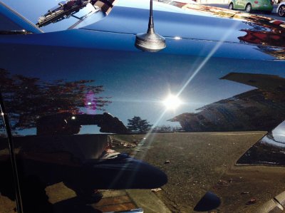

I took advantage of the long weekend and decided to do paint correction. I should have taken pictures before but when it comes time to start, I never do.
Here was my process using the Flex3401:
Thursday - 5 Hours
Wash
Speedy Pro Surface Pad (Clay)
Wolfgang Über Compound - LC Hydro Cyan
Friday - 5 Hours
Wolfgang Finishing Glaze - LC Hydro Tangerine
Saturday - 3 hours
Pinnacle Black Label Surface Cleansing Polish - by hand
PBL Diamond Paint Coating (12 hours to cure) - by hand
Sunday - 1 hour
PBL Diamond Paint Sealant - LC Hydro Crimson
I am tired, let me tell you but I'm really stoked about the results. Still consider myself a rookie, tell me what you guys think?

Best stuff I ever used, first time using a coating. Easy on, easy off. Time will tell as far as durability. I was afraid of temps being to cold for the coating to cure. They recommend 60-70 and no exposure to moisture during the 12 hour curing window...
Wolfgang (Mfg Menzerna) hands down a whole lot easier than M105/M205 combo as application and removing. Uber compound surprisingly finishes as a polish. Really don't need to polish after the compound...

Which stuff streaked? The PBL paint coating? The key to proper paint coating is using of the PBL surface polish to ensure removal of all compound/polish oils to to ensure proper bonding to the paint. I applied using foam applicator as recommended then on the high spots, buff out with clean micro fiber.

Yes, I used the polish, and had clayed and compounded the car before (with Uber as well actually).
The stuff didn't want to NOT streak. And I wasn't about to use a detail spray after like I would on some waxes that are hard to apply.
The application variation I ended up using worked well. I went to was the car a couple weeks later and could basically rinse it clean.
You know that stuff is "supposed" to last 2-3 yrs, right?
28ONE
Jul 8, 2010
1,767
The City
Key word suppose too! Shit I'd be happy if it last a year
