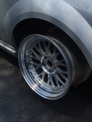

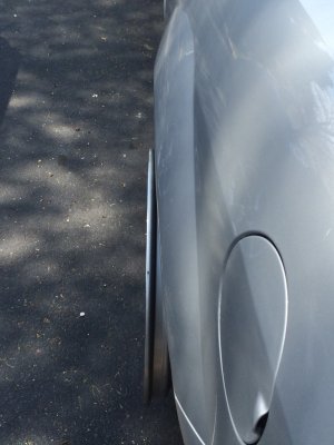

Got my 18s today. Just threw one on the rear to see how it fits. I like the aggressive offset a lot! +25 offset btw ImageUploadedByTapatalk1398203319.446893.jpgImageUploadedByTapatalk1398203332.445683.jpgImageUploadedByTapatalk1398203343.013408.jpgImageUploadedByTapatalk1398203350.045759.jpg

Got them mounted up yesterday. The fit is awesome! I love the aggressive offset. A 275 tire was a perfect fit.

You know what they say... if you can't say anything nice, don't say anything at all......
None of the wheels in this thread fit the cars they are on. Wheels/tires that extend beyond the fender coverage don't fit correctly. Is that nice or not nice?

Dare to be different. I was sick and tired of seeing the same 3 types of wheels on our cars. I personally prefer the "poke" of these wheels over a flush mount, I think it makes the car look wider and more aggressive. And no rubbing at all.
