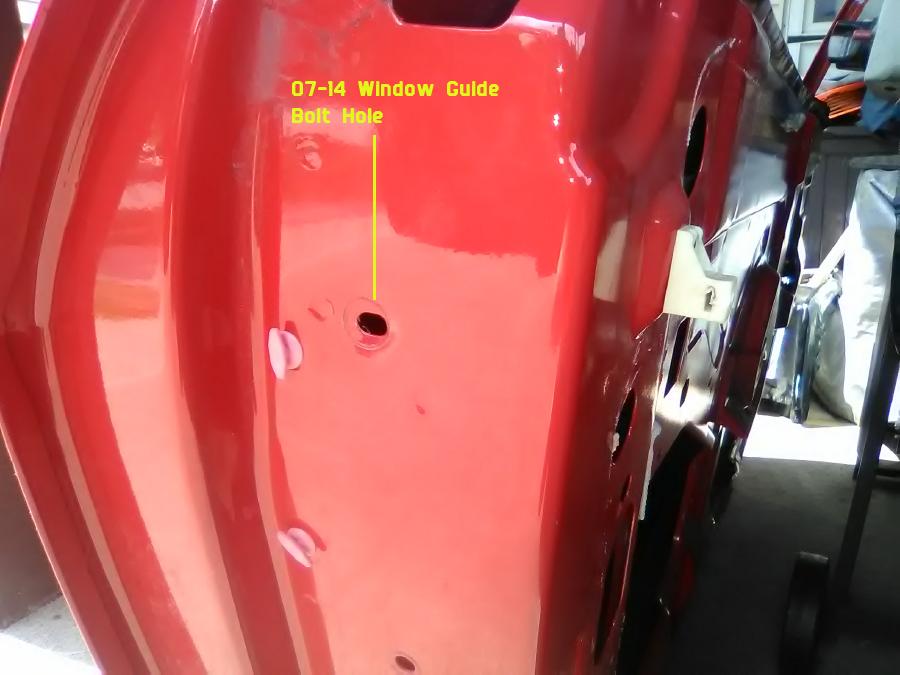

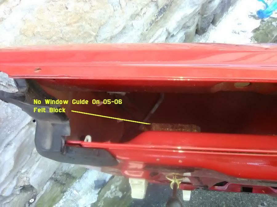

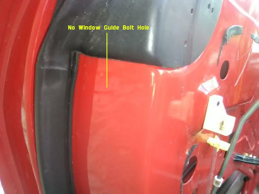

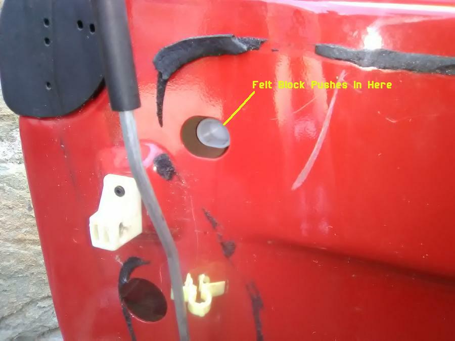

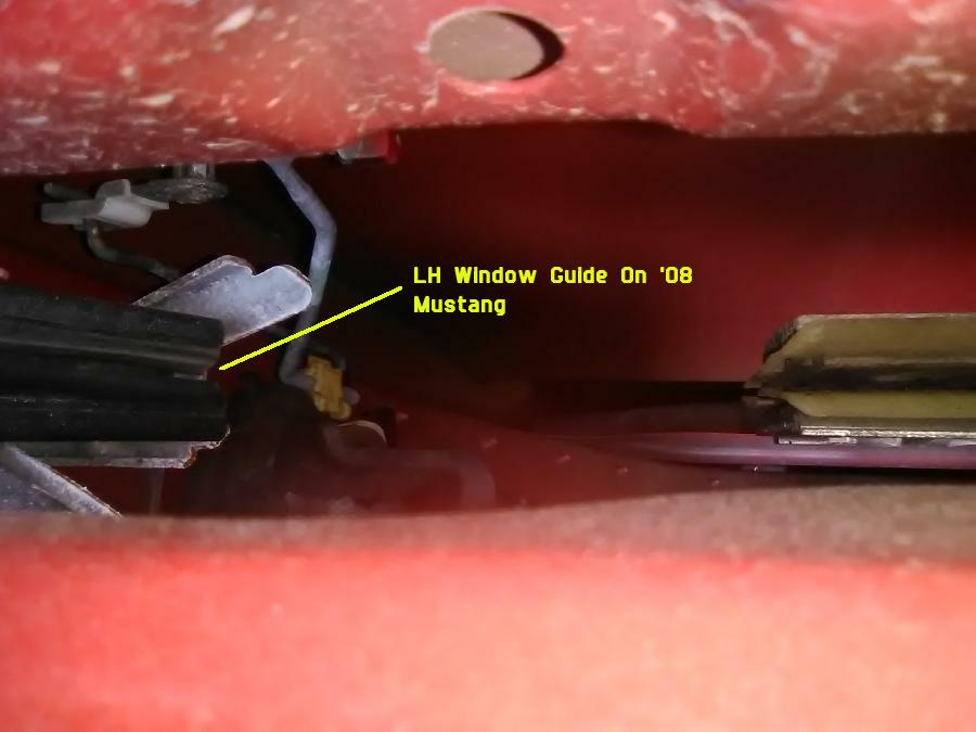

The point IS, the driver side, that part doesn't exist. You would have
to drill one hole to use it on the 05-09. They get a felt block instead of
a nice window guide...
07-14:
05-06:
05-06:
No bolt hole:
07-14:
