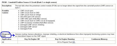

I actually have not checked....but will...(volts etc) however....I hear that the alternator issue is a diode....all I know is last year same issue...then battery was dead one morning.....replaced battery....issue went away...until recently...I have also read it could be caused by electric interferrence..causing the codes....I would be nervous to go through my wiring harness as some have suggested...but may have to....I have been told the only way to check if it is the alternator causing this is with an oscilator wave....dont have one of those...I do not feel it is anything major as the symptoms of rough idling etc for the 0340 code...dont even exist on my car....just the CEL coming on and throwing the code....so I am here contemplating.....replace alternator....process of elimination....if it is interference....where and what...thx for any advice....

If it's not your alternator, you would be the first person I know of that got the P0340/P0344 for some other reason. Just replace the alternator before you get stuck somewhere and have to add a tow truck bill to the cost, too.
BTW, I got a rebuilt unit here locally that has lasted longer than either of the two Ford alternators that went bad on me before that. I paid $270 total, and that included a new 8-rib pulley too.
