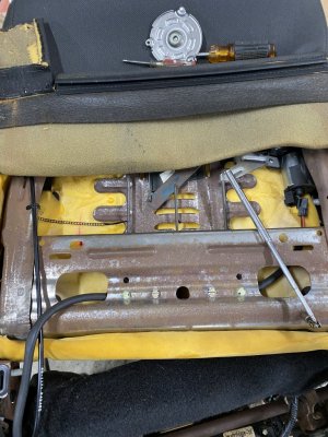

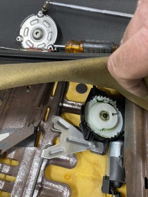

February build date. The motor works, the plastic gears inside broke. The whole mechanism is NOT plastic like all the ones I've seen, it is metal and vertical on the frame.
Cant seem to find anything online, really just need the gears.
My seats are cloth with Mustangs all over it, and is power adjustable.

You obviously want OEM parts. The two links above are two of the lowest price dealer parts houses in the country. You can look up any and all parts still available through Ford on their websites using your VIN so you are guaranteed to get the correct part. Even if they don't have it, you can get the Ford part number and then search that number.
You're welcome.

Ok, thank you, I have searched by VIN, but it comes up with the plastic horizontal mounted mechanism. Mine is not that, its vertical and made of steel. I guess will just place it in the extended position and weld it if I have to. (remove from seat first)
