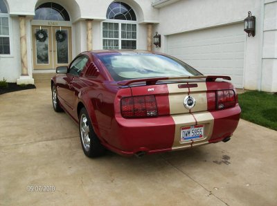

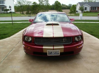

Thanks for all the good info guys. Here are pics of my car right before I bought it. I didn't like the wheels, so the guy I bought it from (ebay) cut the price $1000 and put the V6 originals back on. It is a rebuilt wreck, so when he fixed it he put front and rear GT bumpers and side skirts and even painted the mirrors redfire. Also added hood scoop and gold striping down the middle. I think I will remove the cobras and just put GT on fenders. I also have the GT grill with fogs that I think I'll put on.
Thanks Again, Mike
