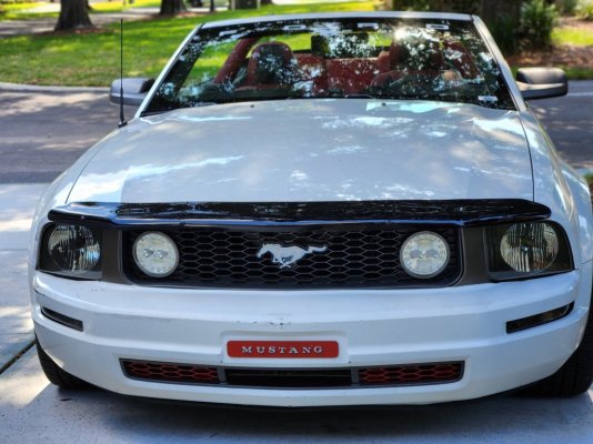

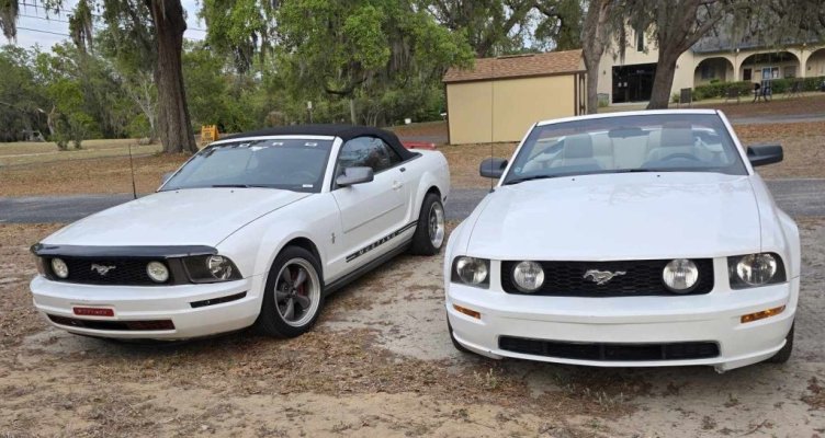

On my V6 I used a hole saw on the grille and added generic halo lamps from Amazon.
I made brackets to secure them and wired relays to light them, using the yellow halos as turn signals. It was inexpensive, relatively easy, and looked great.
Now that I'm prepping it to sell, I found a Pony package grille and installed it, but so far it is not wired in.

The V6 with homemade fogs is on the left, the GT I brought home on the right:

Thanks for sharing, I've already gleaned both a switch and OEM Pony grille and installed them on my V6, and may make up a harness to wire it up before I put it up for sale. where does that nice Starkey fog light harness plug into?
Before buying my GT, I had made up my own fog light grille and wiring for the V6, but prefer to sell it with something more oem for the next owner.
