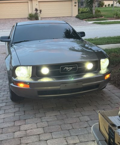

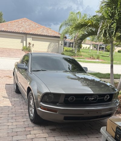

On my V6 I used a hole saw on the grille and added generic halo lamps from Amazon.
I made brackets to secure them and wired relays to light them, using the yellow halos as turn signals. It was inexpensive, relatively easy, and looked great.

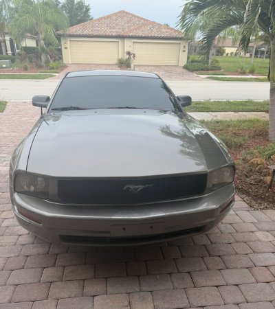

Now that I'm prepping it to sell, I found a Pony package grille and installed it, but so far it is not wired in.

The V6 with homemade fogs is on the left, the GT I brought home on the right:
