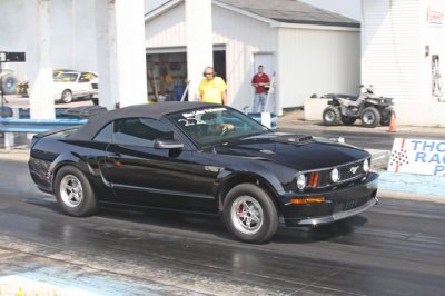

My friend has a 2005 mustang convertible with a 4.6L 3V
motor is a built low comp.(8.5-1) with stage 2 heads and stage 3 cams
roush 2.3L single belt TVS with CDC shaker mounted on blowerand long tubes with no cats (h pipe)
Automatic (5R55) with 3000 stall and tci rachet shifter
8.8 rearend with tru trac and 3.90 gears
car is full factory trim and has a amp in the trunk - only thing removed is front swaybar and spare tire
car weighs 4100 and is around 670 rwhp
went out sunday (10-23-2011) and went 10.66 @ 128 with a 1.46 60 ft.also ran a 10.71 and 10.79 (we were playing with rear suspension)(tires were spinning on rims-need to screw them to rims)
Thanks to Blue Collar Performance this car is a beast​

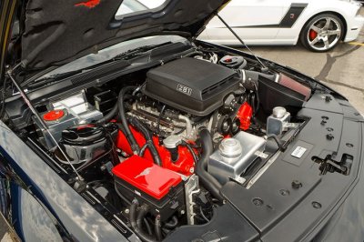

I really really hate bringing up an old thread (even though its only a couple months old) but do you have any more pictures of his blower/intake set up. Im fixing to install the Roush TVS on my 05, and i LOVE the shaker idea.
Was originally going to buy the Supershaker but decided that i wanted the roush blower instead.

This car originally was a V6 with a Vortech and the shaker. After he blew up the 4.0 on the dyno with a huge amount of boost, he swapped a 4.6 in - then put the vortech on it. He blew that and ended up with the current aluminator, with the Vortech. But he wanted the low end torque from the TVS so pulled the vortech.
He already had the shaker and the hood cut out so had to fabricate a way to mount the shaker to the TVS. Roush told him it couldn't be done. Just took a little time to figure out how to do it and some fabrication work.
