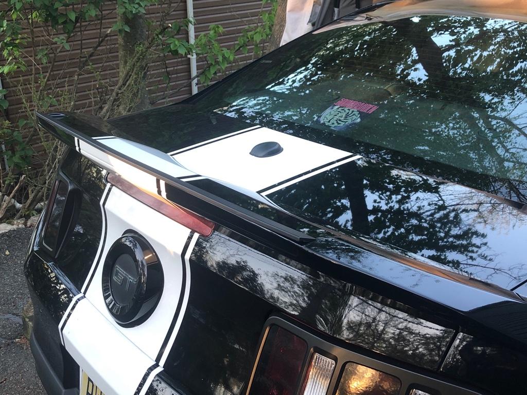

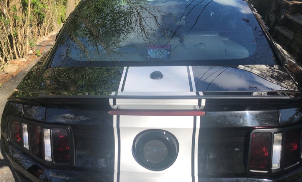

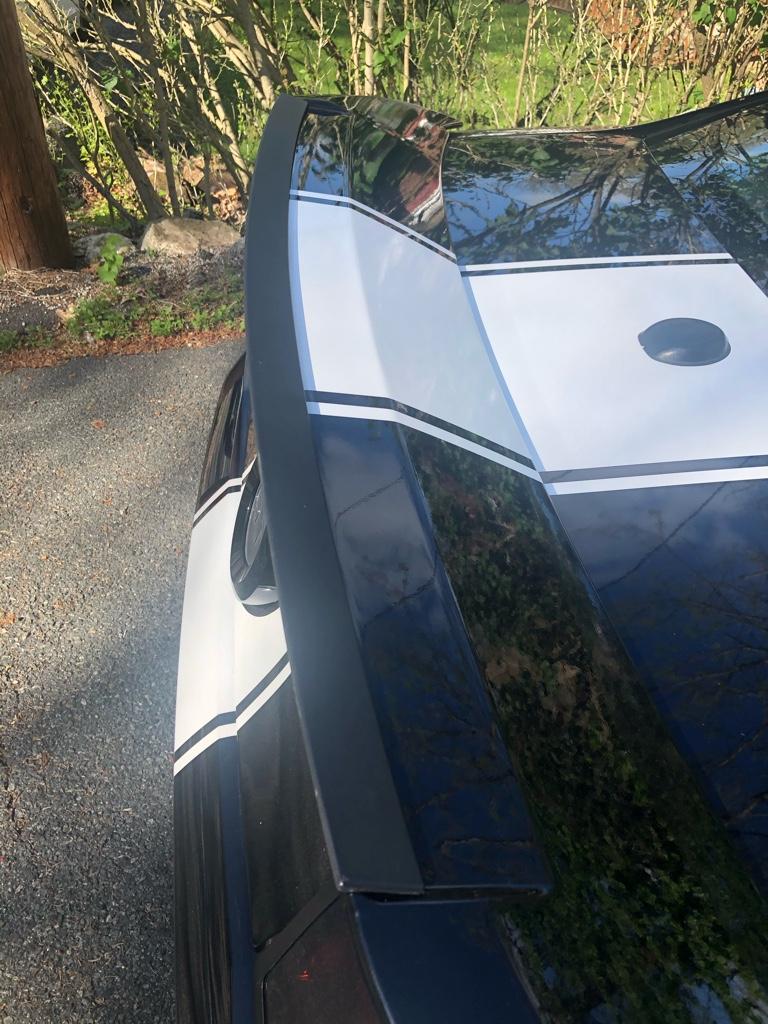

I have an eBay special gt500 spoiler on my 2010 GT that I decided to add a gurney lip/flap to. It’s a factory flap, but the spoiler had no attachment points. So I ground down the dowels and used heavy duty 3M automotive tape to attach it. Not sure if it’ll hold under pressure-guess I’ll find out!

As long as you used the automotive 3M it should be good. If it does come lose, when you reapply get some adhesive promoter to apply before the tape.
I like it!
