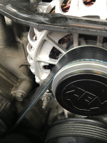

Get er done. O'reilly auto re manufactured special. Seems like a good unit.
I cleaned the throttle body too. It was pretty filthy.
Engine is running really smooth, alternator is gathering electricity, and my > 5,500 rpm "hang" is GONE! (not sure if from wonky voltage or dirty throttle body) Last month I tried to get it tuned out with the throttle decay settings, but that only helped marginally. It's perfect now.
Thanks for all the help and suggestions!
R.M.
DAT NEW BELT! Fresh Son.
